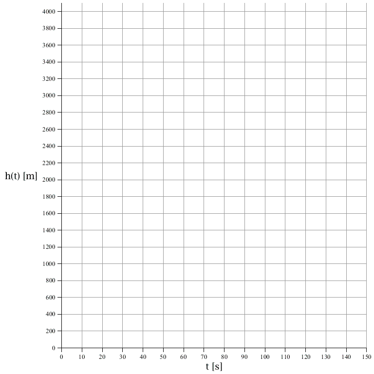

plot(H, t = 0 .. 150, y = 0 .. 4100, axis[2] = [gridlines = 30], axis[1] = [gridlines = 20], labels = ["t [s]", "h(t) [m]"], labelfont = ["Times", 15], color = "red", size = [1000, 1000])
Warning, expecting only range variable t in expression H to be plotted but found name H
