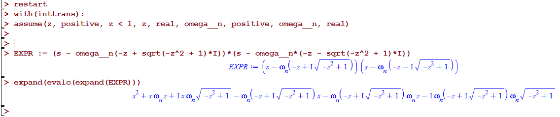

Hi,
I'm trying to make Maple reduce an extensively simple complex equation, something so simple anybody with basic knowledge of complex numbers would take about 2 mins to solve manually.
Yet, I can't seem to get Maple to do it, which is disappointing. I can only hope the issue is on my side (I would be glad to be the one in the wrong).
example.mw
I expect at the last line a reduction to s^2 + 2*z*omega__n * s + omega__n^2
I tried different combinations of simplification functions without success. Simplify doesn't work much better.

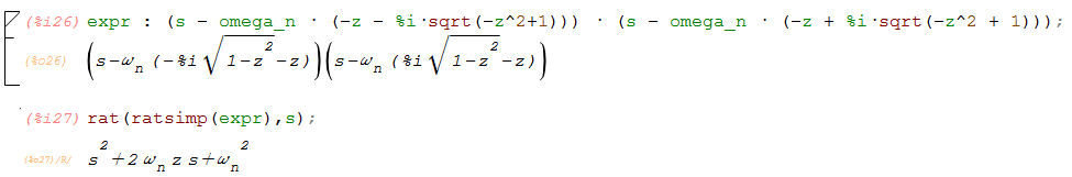

Basically looking at something like this, but on Maple (this comes from Maxima), if possible *WITHOUT* the need for assume() on any scale (just like Maxima and Mathematica) :
