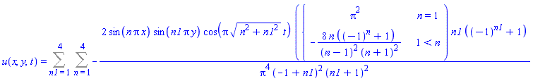

pdsol := pdsolve({pde, bc, ic});
"pdsol:=u(x,y,t)=(&sum;) (&sum;)-(2 sin(n Pi x) sin(n1 Pi y) cos(Pi sqrt(n^2+n1^2) t) ({[[Pi^2,n=1],[-(8 n ((-1)^n+1))/((n-1)^2 (n+1)^2),1<n]]) n1 ((-1)^n1+1))/(Pi^4 (-1+n1)^2 (n1+1)^2)"
eval(pdsol, infinity=4);
value(%);
"u(x,y,t)=(&sum;) (&sum;)-(2 sin(n Pi x) sin(n1 Pi y) cos(Pi sqrt(n^2+n1^2) t) ({[[Pi^2,n=1],[-(8 n ((-1)^n+1))/((n-1)^2 (n+1)^2),1<n]]) n1 ((-1)^n1+1))/(Pi^4 (-1+n1)^2 (n1+1)^2)"
Error, (in SumTools:-DefiniteSum:-ClosedForm) summand is singular in the interval of summation
