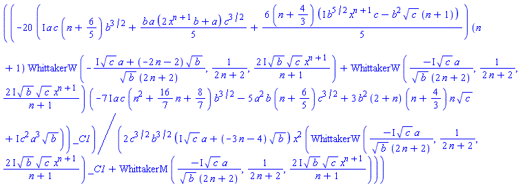

#2031
#Book: Ordinary differential equations and their solutions. By George Moseley Murphy. 1960
#Section: Various 3
#Problem number: 57.
ode:=diff(y(x),x) = a*x^(n-1)+b*x^(2*n)+c*y(x)^2;
sol:=dsolve(ode,y(x)):
odetest(sol,ode):
simplify(%)
diff(y(x), x) = a*x^(n-1)+b*x^(2*n)+c*y(x)^2
(1/2)*(-20*(I*a*c*(n+6/5)*b^(3/2)+(1/5)*b*a*(2*x^(n+1)*b+a)*c^(3/2)+(6/5)*(n+4/3)*(I*b^(5/2)*x^(n+1)*c-b^2*c^(1/2)*(n+1)))*(n+1)*WhittakerW(-(I*c^(1/2)*a+(-2*n-2)*b^(1/2))/(b^(1/2)*(2*n+2)), 1/(2*n+2), (2*I)*b^(1/2)*c^(1/2)*x^(n+1)/(n+1))+WhittakerW(-I*c^(1/2)*a/(b^(1/2)*(2*n+2)), 1/(2*n+2), (2*I)*b^(1/2)*c^(1/2)*x^(n+1)/(n+1))*(-(7*I)*a*c*(n^2+(16/7)*n+8/7)*b^(3/2)-5*a^2*b*(n+6/5)*c^(3/2)+3*b^2*(2+n)*(n+4/3)*n*c^(1/2)+I*c^2*a^3*b^(1/2)))*_C1/(c^(3/2)*b^(3/2)*(I*c^(1/2)*a+(-3*n-4)*b^(1/2))*x^2*(WhittakerW(-I*c^(1/2)*a/(b^(1/2)*(2*n+2)), 1/(2*n+2), (2*I)*b^(1/2)*c^(1/2)*x^(n+1)/(n+1))*_C1+WhittakerM(-I*c^(1/2)*a/(b^(1/2)*(2*n+2)), 1/(2*n+2), (2*I)*b^(1/2)*c^(1/2)*x^(n+1)/(n+1))))

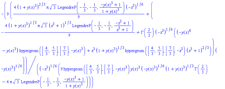

#2372
#Section: Various 14
#Problem number: 407
ode:=diff(y(x),x)*(x^3+1)^(2/3)+(1+y(x)^3)^(2/3) = 0;
odetest(sol,ode):
simplify(%)
(diff(y(x), x))*(x^3+1)^(2/3)+(1+y(x)^3)^(2/3) = 0
-9*((4/9)*(1+y(x)^3)^(2/3)*Pi*3^(1/2)*LegendreP(-1/3, -1/3, (-y(x)^3+1)/(1+y(x)^3))*(-x^3)^(1/6)+(-(4/9)*(1+y(x)^3)^(1/3)*Pi*3^(1/2)*(x^3+1)^(1/3)*LegendreP(-1/3, -1/3, (-x^3+1)/(x^3+1))+GAMMA(2/3)*(-x^3)^(1/6)*((-y(x)^6-y(x)^3)*hypergeom([4/3, 5/3], [7/3], -y(x)^3)+x^3*(1+y(x)^3)^(1/3)*hypergeom([4/3, 5/3], [7/3], -x^3)*(x^3+1)^(2/3)))*(-y(x)^3)^(1/6))/((-x^3)^(1/6)*(9*hypergeom([4/3, 5/3], [7/3], -y(x)^3)*y(x)^3*(-y(x)^3)^(1/6)*(1+y(x)^3)^(1/3)*GAMMA(2/3)-4*Pi*3^(1/2)*LegendreP(-1/3, -1/3, (-y(x)^3+1)/(1+y(x)^3))))

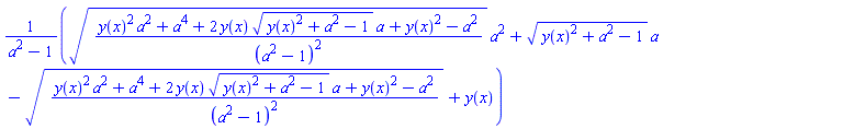

#3035
#Section: Various 37
#Problem number: 1118.
ode:=(diff(y(x),x)^2+1)^(1/2)+a*diff(y(x),x) = x;
sol:=[dsolve(ode,y(x))]:
odetest(sol[1],ode):
simplify(%);
odetest(sol[2],ode):
simplify(%)
((diff(y(x), x))^2+1)^(1/2)+a*(diff(y(x), x)) = x
((a^2+x^2-1)^(1/2)*(a^2-1)*((a^4+(x^2-1)*a^2+2*a*x*(a^2+x^2-1)^(1/2)+x^2)/(a^2-1)^2)^(1/2)+a^3+a*x^2+x*(a^2+x^2-1)^(1/2)-a)/((a^2+x^2-1)^(1/2)*(a^2-1))
-((-a^2+1)*(a^2+x^2-1)^(1/2)*((a^4+(x^2-1)*a^2-2*a*x*(a^2+x^2-1)^(1/2)+x^2)/(a^2-1)^2)^(1/2)+a^3+a*x^2-x*(a^2+x^2-1)^(1/2)-a)/((a^2+x^2-1)^(1/2)*(a^2-1))

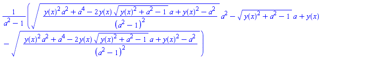

#3036
#Problem number: 1119.
ode:=(diff(y(x),x)^2+1)^(1/2)+a*diff(y(x),x) = y(x);
sol:=[dsolve(ode,y(x))];
simplify(%);
simplify(%)

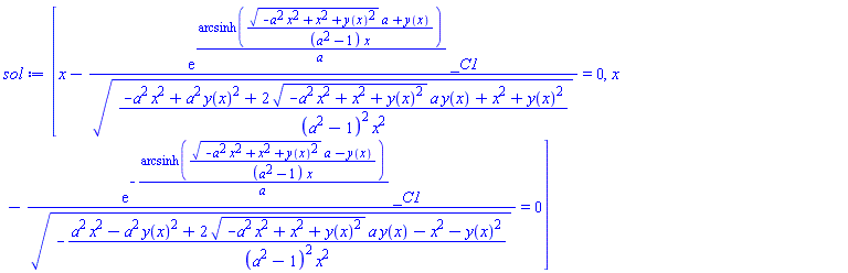

((diff(y(x), x))^2+1)^(1/2)+a*(diff(y(x), x)) = y(x)
[x-Intat(-(a-1)*(a+1)/(-a*_a+(_a^2+a^2-1)^(1/2)), _a = y(x))-_C1 = 0, x-Intat((a-1)*(a+1)/(a*_a+(_a^2+a^2-1)^(1/2)), _a = y(x))-_C1 = 0]
(((y(x)^2*a^2+a^4-2*y(x)*(y(x)^2+a^2-1)^(1/2)*a+y(x)^2-a^2)/(a^2-1)^2)^(1/2)*a^2-(y(x)^2+a^2-1)^(1/2)*a+y(x)-((y(x)^2*a^2+a^4-2*y(x)*(y(x)^2+a^2-1)^(1/2)*a+y(x)^2-a^2)/(a^2-1)^2)^(1/2))/(a^2-1)
(((y(x)^2*a^2+a^4+2*y(x)*(y(x)^2+a^2-1)^(1/2)*a+y(x)^2-a^2)/(a^2-1)^2)^(1/2)*a^2+(y(x)^2+a^2-1)^(1/2)*a-((y(x)^2*a^2+a^4+2*y(x)*(y(x)^2+a^2-1)^(1/2)*a+y(x)^2-a^2)/(a^2-1)^2)^(1/2)+y(x))/(a^2-1)
#3040
#Problem number: 1126.
ode:=a*x*(diff(y(x),x)^2+1)^(1/2)+x*diff(y(x),x)-y(x) = 0;
odetest(sol[1],ode): #too large to display
odetest(sol[2],ode): #too large to display
a*x*((diff(y(x), x))^2+1)^(1/2)+x*(diff(y(x), x))-y(x) = 0
[x-exp(arcsinh(((-a^2*x^2+x^2+y(x)^2)^(1/2)*a+y(x))/((a^2-1)*x))/a)*_C1/((-a^2*x^2+a^2*y(x)^2+2*(-a^2*x^2+x^2+y(x)^2)^(1/2)*a*y(x)+x^2+y(x)^2)/((a^2-1)^2*x^2))^(1/2) = 0, x-exp(-arcsinh(((-a^2*x^2+x^2+y(x)^2)^(1/2)*a-y(x))/((a^2-1)*x))/a)*_C1/(-(a^2*x^2-a^2*y(x)^2+2*(-a^2*x^2+x^2+y(x)^2)^(1/2)*a*y(x)-x^2-y(x)^2)/((a^2-1)^2*x^2))^(1/2) = 0]

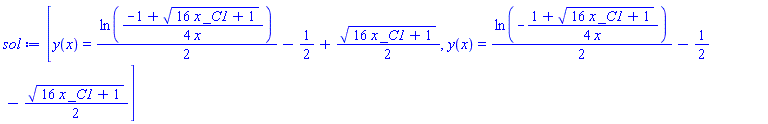

#3054
#Problem number: 1146.
ode:=ln(diff(y(x),x))+4*x*diff(y(x),x)-2*y(x) = 0;
simplify(%);
simplify(%);
ln(diff(y(x), x))+4*x*(diff(y(x), x))-2*y(x) = 0
[y(x) = (1/2)*ln((1/4)*(-1+(16*_C1*x+1)^(1/2))/x)-1/2+(1/2)*(16*_C1*x+1)^(1/2), y(x) = (1/2)*ln(-(1/4)*(1+(16*_C1*x+1)^(1/2))/x)-1/2-(1/2)*(16*_C1*x+1)^(1/2)]
ln(2)+ln((8*x*_C1-(16*_C1*x+1)^(1/2)+1)/(x*(-1+(16*_C1*x+1)^(1/2))))-ln((-1+(16*_C1*x+1)^(1/2))/x)
ln(2)+ln((-8*x*_C1-(16*_C1*x+1)^(1/2)-1)/(x*(1+(16*_C1*x+1)^(1/2))))-ln((-1-(16*_C1*x+1)^(1/2))/x)

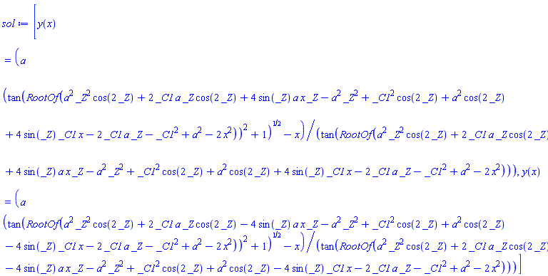

#3138
#Book: Differential Equations, By George Boole F.R.S. 1865
#Section: Chapter 7
#Problem number: 17
ode:=x+y(x)*diff(y(x),x) = a*(diff(y(x),x)^2+1)^(1/2);
odetest(sol[1],ode): #WARNING. hangs. try with timelimit
[y(x) = (a*(tan(RootOf(a^2*_Z^2*cos(2*_Z)+2*_C1*a*_Z*cos(2*_Z)+4*sin(_Z)*a*x*_Z-a^2*_Z^2+_C1^2*cos(2*_Z)+a^2*cos(2*_Z)+4*sin(_Z)*_C1*x-2*_C1*a*_Z-_C1^2+a^2-2*x^2))^2+1)^(1/2)-x)/tan(RootOf(a^2*_Z^2*cos(2*_Z)+2*_C1*a*_Z*cos(2*_Z)+4*sin(_Z)*a*x*_Z-a^2*_Z^2+_C1^2*cos(2*_Z)+a^2*cos(2*_Z)+4*sin(_Z)*_C1*x-2*_C1*a*_Z-_C1^2+a^2-2*x^2)), y(x) = (a*(tan(RootOf(a^2*_Z^2*cos(2*_Z)+2*_C1*a*_Z*cos(2*_Z)-4*sin(_Z)*a*x*_Z-a^2*_Z^2+_C1^2*cos(2*_Z)+a^2*cos(2*_Z)-4*sin(_Z)*_C1*x-2*_C1*a*_Z-_C1^2+a^2-2*x^2))^2+1)^(1/2)-x)/tan(RootOf(a^2*_Z^2*cos(2*_Z)+2*_C1*a*_Z*cos(2*_Z)-4*sin(_Z)*a*x*_Z-a^2*_Z^2+_C1^2*cos(2*_Z)+a^2*cos(2*_Z)-4*sin(_Z)*_C1*x-2*_C1*a*_Z-_C1^2+a^2-2*x^2))]

ode:=(x^3+1)^(2/3)*diff(y(x),x)+(y(x)^3+1)^(2/3) = 0;
sol:=dsolve(ode,y(x));
check:=simplify(odetest(sol,ode));  #tried other simplication, can't get it to zero. But sol is correct
