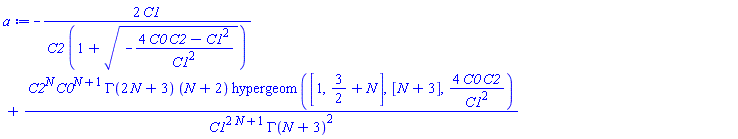

I have two summations that Maple converts to hypergeometric outputs. Is there a way to stop that?
I dont know how to get Maple to expand the Hyper geometric output for a given walue of N
if the value of N is defined first the output is as I would expect.
The real problem, the sumations are nested and when I get to four nested sums Maple sits there for hours trying to evaluate the general case.
I have only included the first 2 summations.
Any insights on this would be appreciated.
a := -(sum(C2^(m-1)*C0^m*factorial(2*m)/(C1^(2*m-1)*factorial(m+1)*factorial(m)), m = 0 .. N))
-2*C1/(C2*(1+(-(4*C0*C2-C1^2)/C1^2)^(1/2)))+C2^N*C0^(N+1)*GAMMA(2*N+3)*(N+2)*hypergeom([1, 3/2+N], [N+3], 4*C0*C2/C1^2)/(C1^(2*N+1)*GAMMA(N+3)^2)
N := 4
4
a
-2*C1/(C2*(1+(-(4*C0*C2-C1^2)/C1^2)^(1/2)))+42*C2^4*C0^5*hypergeom([1, 11/2], [7], 4*C0*C2/C1^2)/C1^9

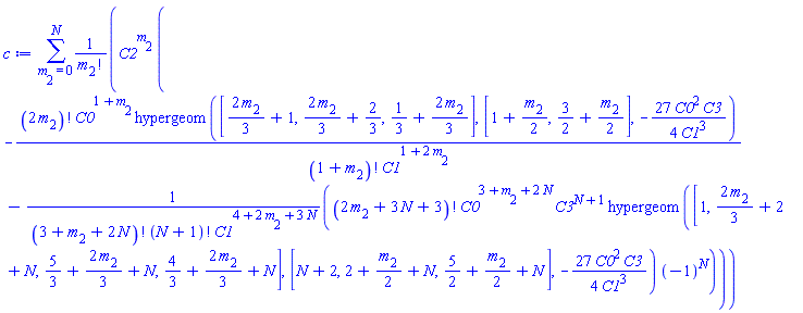

c := sum(sum((-1)^(m[3]+1)*factorial(2*m[2]+3*m[3])*C0^(1+m[2]+2*m[3])*C2^m[2]*C3^m[3]/(factorial(1+m[2]+2*m[3])*factorial(m[2])*factorial(m[3])*C1^(1+2*m[2]+3*m[3])), m[3] = 0 .. N), m[2] = 0 .. N)
sum(C2^m[2]*(-factorial(2*m[2])*C0^(1+m[2])*hypergeom([(2/3)*m[2]+1, (2/3)*m[2]+2/3, 1/3+(2/3)*m[2]], [1+(1/2)*m[2], 3/2+(1/2)*m[2]], -(27/4)*C0^2*C3/C1^3)/(factorial(1+m[2])*C1^(1+2*m[2]))-factorial(2*m[2]+3*N+3)*C0^(3+m[2]+2*N)*C3^(N+1)*hypergeom([1, (2/3)*m[2]+2+N, 5/3+(2/3)*m[2]+N, 4/3+(2/3)*m[2]+N], [N+2, 2+(1/2)*m[2]+N, 5/2+(1/2)*m[2]+N], -(27/4)*C0^2*C3/C1^3)*(-1)^N/(factorial(3+m[2]+2*N)*factorial(N+1)*C1^(4+2*m[2]+3*N)))/factorial(m[2]), m[2] = 0 .. N)

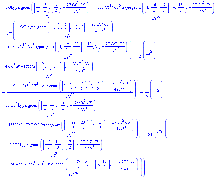

NULLN := 4
4
c
-C0*hypergeom([1/3, 2/3], [3/2], -(27/4)*C0^2*C3/C1^3)/C1-273*C0^11*C3^5*hypergeom([1, 16/3, 17/3], [6, 13/2], -(27/4)*C0^2*C3/C1^3)/C1^16+C2*(-C0^2*hypergeom([1, 4/3, 5/3], [3/2, 2], -(27/4)*C0^2*C3/C1^3)/C1^3-6188*C0^12*C3^5*hypergeom([1, 19/3, 20/3], [13/2, 7], -(27/4)*C0^2*C3/C1^3)/C1^18)+(1/2)*C2^2*(-4*C0^3*hypergeom([5/3, 7/3], [5/2], -(27/4)*C0^2*C3/C1^3)/C1^5-162792*C0^13*C3^5*hypergeom([1, 20/3, 22/3], [6, 15/2], -(27/4)*C0^2*C3/C1^3)/C1^20)+(1/6)*C2^3*(-30*C0^4*hypergeom([7/3, 8/3], [5/2], -(27/4)*C0^2*C3/C1^3)/C1^7-4883760*C0^14*C3^5*hypergeom([1, 22/3, 23/3], [6, 15/2], -(27/4)*C0^2*C3/C1^3)/C1^22)+(1/24)*C2^4*(-336*C0^5*hypergeom([10/3, 11/3], [7/2], -(27/4)*C0^2*C3/C1^3)/C1^9-164745504*C0^15*C3^5*hypergeom([1, 25/3, 26/3], [6, 17/2], -(27/4)*C0^2*C3/C1^3)/C1^24)

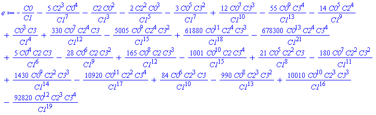

e := sum(sum((-1)^(m[3]+1)*factorial(2*m[2]+3*m[3])*C0^(1+m[2]+2*m[3])*C2^m[2]*C3^m[3]/(factorial(1+m[2]+2*m[3])*factorial(m[2])*factorial(m[3])*C1^(1+2*m[2]+3*m[3])), m[3] = 0 .. N), m[2] = 0 .. N)
-C0/C1-5*C2^3*C0^4/C1^7-C2*C0^2/C1^3-2*C2^2*C0^3/C1^5-3*C0^5*C3^2/C1^7+12*C0^7*C3^3/C1^10-55*C0^9*C3^4/C1^13-14*C0^5*C2^4/C1^9+C0^3*C3/C1^4+330*C0^7*C2^4*C3/C1^12-5005*C0^9*C2^4*C3^2/C1^15+61880*C0^11*C2^4*C3^3/C1^18-678300*C0^13*C2^4*C3^4/C1^21+5*C0^4*C2*C3/C1^6-28*C0^6*C2*C3^2/C1^9+165*C0^8*C2*C3^3/C1^12-1001*C0^10*C2*C3^4/C1^15+21*C0^5*C2^2*C3/C1^8-180*C0^7*C2^2*C3^2/C1^11+1430*C0^9*C2^2*C3^3/C1^14-10920*C0^11*C2^2*C3^4/C1^17+84*C0^6*C2^3*C3/C1^10-990*C0^8*C2^3*C3^2/C1^13+10010*C0^10*C2^3*C3^3/C1^16-92820*C0^12*C2^3*C3^4/C1^19
