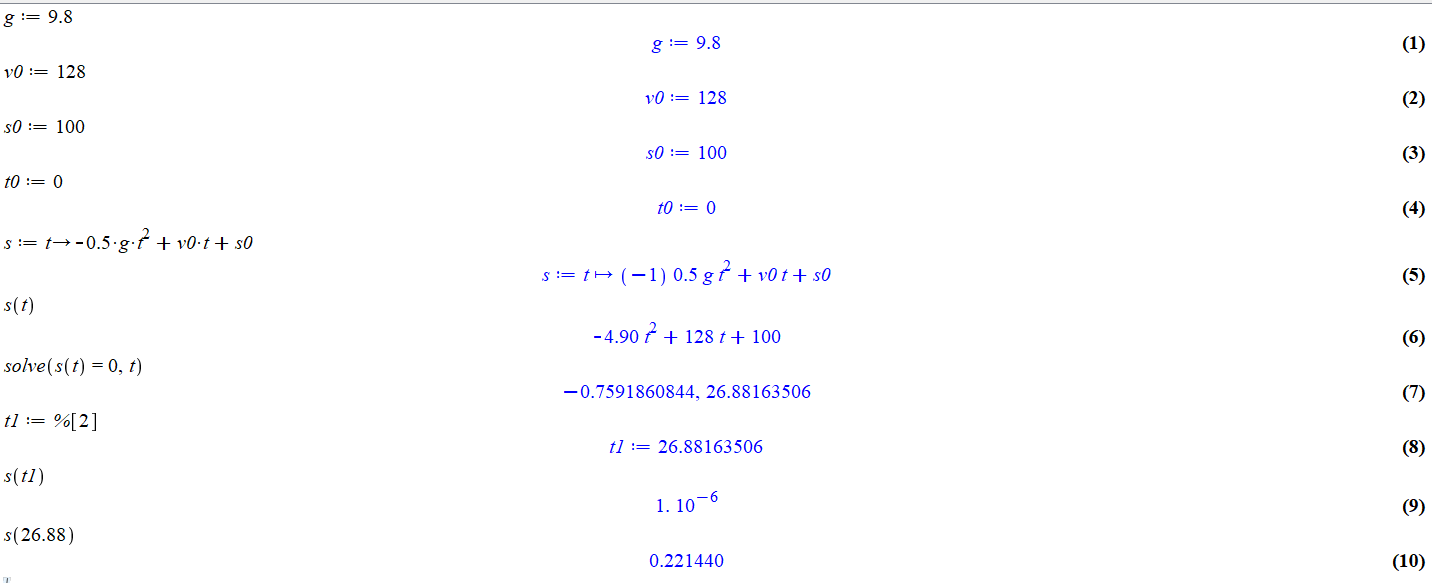

Hi everyone, i'm working on a project and i'm having a problem as such:
I got t1 already (t1=26,88) by solving s(t)=0 and when I try to calculate s(t) with t=t1, i type s(t1) Maple give me 1.10^(-6) as result but the result should be 0.22144. Here are my codes:
