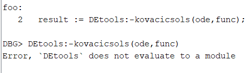

I have code which in module which does this
           DEtools:-kovacicsols(ode,func)
Where ode is some ode and func is y(x).  When I step in the debugger, I get exception at this. It says
       DBG> DEtools:-kovacicsols(ode,func)
       Error, `DEtools` does not evaluate to a module
Same exact code works OK from worksheet as expected.   SO for some reason, inside this module it does not see DEtools and I have no idea why.

I am able to make a MWE. It seems this always happens in the debugger.  But if  I let it run, it works somehow. Only when I try to step into it, it gives error. Here is MWE
interface(warnlevel=4);
kernelopts('assertlevel'=2):
foo:=proc(ode,func)
   local result;
    DEBUG();
    result:=DEtools:-kovacicsols(ode,func);
    return result;
  end proc;
And now
ode:=diff(diff(y(x),x),x) = (-3/16/x^2-2/9/(x-1)^2+3/16/x/(x-1))*y(x);
func:=y(x);
foo(ode,y(x))
Now in the debugger if I do DEtools:-kovacicsols(ode,func) or if I stepin the call, I get the error. But I hit the continue botton, I do not get the error and it gives solution.
Why this happens?
