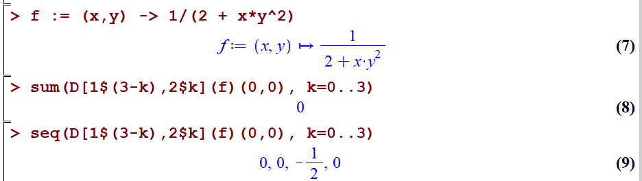

Please take a look at the following code-snippet:
Output (9) is as expected, but output (8) is not !!
I would expect output (8) to be equal to the sum of output (9), i.e. to be equal to (-1/2).
Please illuminate why I don't get the sum of the sequence (9) as my output (8).
