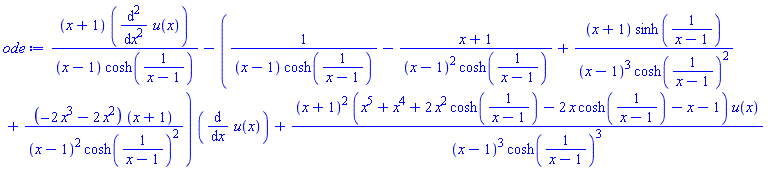

ode:=(x + 1)*diff(u(x), x, x)/((x - 1)*cosh(1/(x - 1))) - (1/((x - 1)*cosh(1/(x - 1))) - (x + 1)/((x - 1)^2*cosh(1/(x - 1))) + (x + 1)*sinh(1/(x - 1))/((x - 1)^3*cosh(1/(x - 1))^2) + (-2*x^3 - 2*x^2)*(x + 1)/((x - 1)^2*cosh(1/(x - 1))^2))*diff(u(x), x) + (x + 1)^2*(x^5 + x^4 + 2*x^2*cosh(1/(x - 1)) - 2*x*cosh(1/(x - 1)) - x - 1)*u(x)/((x - 1)^3*cosh(1/(x - 1))^3);
(x+1)*(diff(diff(u(x), x), x))/((x-1)*cosh(1/(x-1)))-(1/((x-1)*cosh(1/(x-1)))-(x+1)/((x-1)^2*cosh(1/(x-1)))+(x+1)*sinh(1/(x-1))/((x-1)^3*cosh(1/(x-1))^2)+(-2*x^3-2*x^2)*(x+1)/((x-1)^2*cosh(1/(x-1))^2))*(diff(u(x), x))+(x+1)^2*(x^5+x^4+2*x^2*cosh(1/(x-1))-2*x*cosh(1/(x-1))-x-1)*u(x)/((x-1)^3*cosh(1/(x-1))^3)

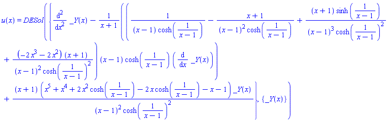

dsolve(ode); #after about 1 minute...
u(x) = DESol({diff(diff(_Y(x), x), x)-(1/((x-1)*cosh(1/(x-1)))-(x+1)/((x-1)^2*cosh(1/(x-1)))+(x+1)*sinh(1/(x-1))/((x-1)^3*cosh(1/(x-1))^2)+(-2*x^3-2*x^2)*(x+1)/((x-1)^2*cosh(1/(x-1))^2))*(x-1)*cosh(1/(x-1))*(diff(_Y(x), x))/(x+1)+(x+1)*(x^5+x^4+2*x^2*cosh(1/(x-1))-2*x*cosh(1/(x-1))-x-1)*_Y(x)/((x-1)^2*cosh(1/(x-1))^2)}, {_Y(x)})
