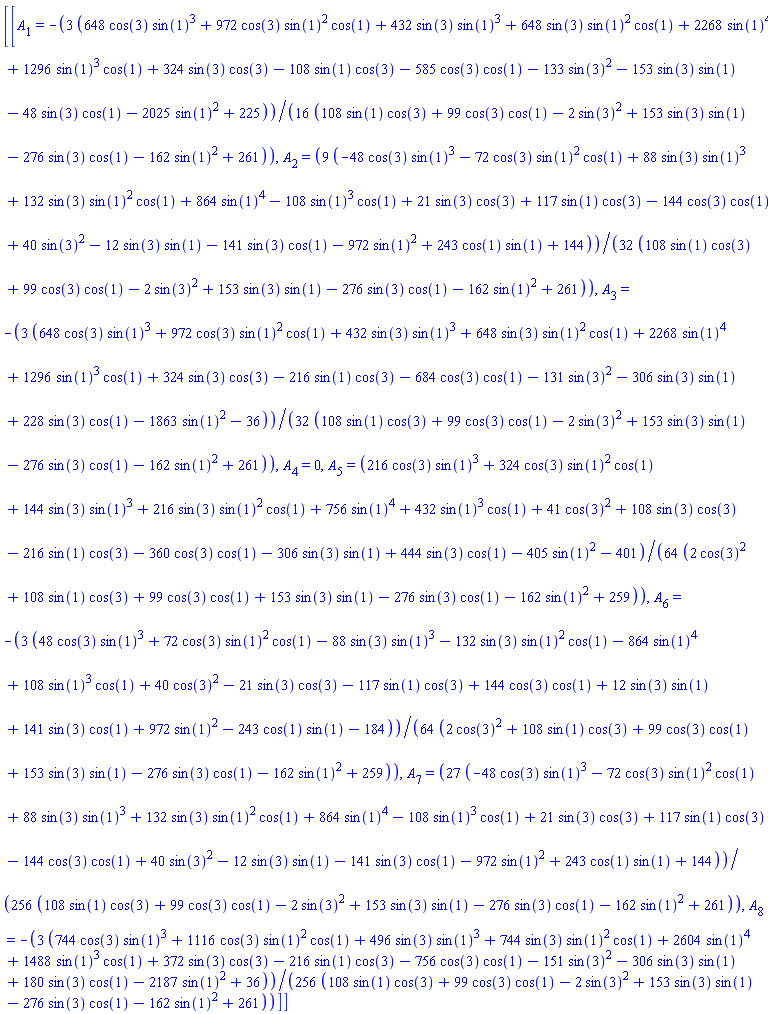

eq:=-2*A[1]*sin(x)+2*A[2]*cos(x)-4*A[2]*x*sin(x)+2*A[3]*sin(x)+4*A[3]*x*cos(x)+2*A[4]*cos(x)-6*A[5]*sin(3*x)-8*A[5]*x*cos(3*x)+6*A[6]*cos(3*x)-8*A[6]*x*sin(3*x)-8*A[7]*cos(3*x)-8*A[8]*sin(3*x) = x*cos(x)^3;
solve(identity(eq,x),trial_solution_constants)
[A[1], A[2], A[3], A[4], A[5], A[6], A[7], A[8]]
[[A[1] = -(3/16)*(648*cos(3)*sin(1)^3+972*cos(3)*sin(1)^2*cos(1)+432*sin(3)*sin(1)^3+648*sin(3)*sin(1)^2*cos(1)+2268*sin(1)^4+1296*sin(1)^3*cos(1)+324*sin(3)*cos(3)-108*sin(1)*cos(3)-585*cos(3)*cos(1)-133*sin(3)^2-153*sin(3)*sin(1)-48*sin(3)*cos(1)-2025*sin(1)^2+225)/(108*sin(1)*cos(3)+99*cos(3)*cos(1)-2*sin(3)^2+153*sin(3)*sin(1)-276*sin(3)*cos(1)-162*sin(1)^2+261), A[2] = (9/32)*(-48*cos(3)*sin(1)^3-72*cos(3)*sin(1)^2*cos(1)+88*sin(3)*sin(1)^3+132*sin(3)*sin(1)^2*cos(1)+864*sin(1)^4-108*sin(1)^3*cos(1)+21*sin(3)*cos(3)+117*sin(1)*cos(3)-144*cos(3)*cos(1)+40*sin(3)^2-12*sin(3)*sin(1)-141*sin(3)*cos(1)-972*sin(1)^2+243*cos(1)*sin(1)+144)/(108*sin(1)*cos(3)+99*cos(3)*cos(1)-2*sin(3)^2+153*sin(3)*sin(1)-276*sin(3)*cos(1)-162*sin(1)^2+261), A[3] = -(3/32)*(648*cos(3)*sin(1)^3+972*cos(3)*sin(1)^2*cos(1)+432*sin(3)*sin(1)^3+648*sin(3)*sin(1)^2*cos(1)+2268*sin(1)^4+1296*sin(1)^3*cos(1)+324*sin(3)*cos(3)-216*sin(1)*cos(3)-684*cos(3)*cos(1)-131*sin(3)^2-306*sin(3)*sin(1)+228*sin(3)*cos(1)-1863*sin(1)^2-36)/(108*sin(1)*cos(3)+99*cos(3)*cos(1)-2*sin(3)^2+153*sin(3)*sin(1)-276*sin(3)*cos(1)-162*sin(1)^2+261), A[4] = 0, A[5] = (1/64)*(216*cos(3)*sin(1)^3+324*cos(3)*sin(1)^2*cos(1)+144*sin(3)*sin(1)^3+216*sin(3)*sin(1)^2*cos(1)+756*sin(1)^4+432*sin(1)^3*cos(1)+41*cos(3)^2+108*sin(3)*cos(3)-216*sin(1)*cos(3)-360*cos(3)*cos(1)-306*sin(3)*sin(1)+444*sin(3)*cos(1)-405*sin(1)^2-401)/(2*cos(3)^2+108*sin(1)*cos(3)+99*cos(3)*cos(1)+153*sin(3)*sin(1)-276*sin(3)*cos(1)-162*sin(1)^2+259), A[6] = -(3/64)*(48*cos(3)*sin(1)^3+72*cos(3)*sin(1)^2*cos(1)-88*sin(3)*sin(1)^3-132*sin(3)*sin(1)^2*cos(1)-864*sin(1)^4+108*sin(1)^3*cos(1)+40*cos(3)^2-21*sin(3)*cos(3)-117*sin(1)*cos(3)+144*cos(3)*cos(1)+12*sin(3)*sin(1)+141*sin(3)*cos(1)+972*sin(1)^2-243*cos(1)*sin(1)-184)/(2*cos(3)^2+108*sin(1)*cos(3)+99*cos(3)*cos(1)+153*sin(3)*sin(1)-276*sin(3)*cos(1)-162*sin(1)^2+259), A[7] = (27/256)*(-48*cos(3)*sin(1)^3-72*cos(3)*sin(1)^2*cos(1)+88*sin(3)*sin(1)^3+132*sin(3)*sin(1)^2*cos(1)+864*sin(1)^4-108*sin(1)^3*cos(1)+21*sin(3)*cos(3)+117*sin(1)*cos(3)-144*cos(3)*cos(1)+40*sin(3)^2-12*sin(3)*sin(1)-141*sin(3)*cos(1)-972*sin(1)^2+243*cos(1)*sin(1)+144)/(108*sin(1)*cos(3)+99*cos(3)*cos(1)-2*sin(3)^2+153*sin(3)*sin(1)-276*sin(3)*cos(1)-162*sin(1)^2+261), A[8] = -(3/256)*(744*cos(3)*sin(1)^3+1116*cos(3)*sin(1)^2*cos(1)+496*sin(3)*sin(1)^3+744*sin(3)*sin(1)^2*cos(1)+2604*sin(1)^4+1488*sin(1)^3*cos(1)+372*sin(3)*cos(3)-216*sin(1)*cos(3)-756*cos(3)*cos(1)-151*sin(3)^2-306*sin(3)*sin(1)+180*sin(3)*cos(1)-2187*sin(1)^2+36)/(108*sin(1)*cos(3)+99*cos(3)*cos(1)-2*sin(3)^2+153*sin(3)*sin(1)-276*sin(3)*cos(1)-162*sin(1)^2+261)]]
simplify(%);
[[A[1] = 3/16, A[2] = 0, A[3] = 3/16, A[4] = 0, A[5] = -1/32, A[6] = 0, A[7] = 0, A[8] = 3/128]]
