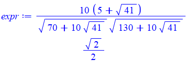

Is it possible to simplify the following relatively simple expression  (10*(5+sqrt(41)))/(sqrt(70+10*sqrt(41))*sqrt(130+10*sqrt(41)))  using 1-2 standard commands  simplify , combine, radnormal  and so on?   I was unable to do this in Maple 2018. Maybe newer versions of Maple will be able to handle this. I managed to simplify it in 3 steps:
expr:=(10*(5+sqrt(41)))/(sqrt(70+10*sqrt(41))*sqrt(130+10*sqrt(41)));
sqrt(simplify(expr^2));
