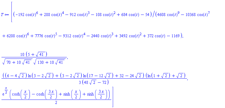

#test cases
T:=[(-192*cos(t)^6 + 288*cos(t)^4 - 912*cos(t)^3 - 108*cos(t)^2 + 684*cos(t) - 54)/(4608*cos(t)^9 - 10368*cos(t)^7 + 6208*cos(t)^6 + 7776*cos(t)^5 - 9312*cos(t)^4 - 2440*cos(t)^3 + 3492*cos(t)^2 + 372*cos(t) - 1169),
(10*(5+sqrt(41)))/(sqrt(70+10*sqrt(41))*sqrt(130+10*sqrt(41))),
((6-4*sqrt(2))*ln(3-2*sqrt(2))+(3-2*sqrt(2))*ln(17-12*sqrt(2))+32-24*sqrt(2))/(48*sqrt(2)-72)*(ln(sqrt(2)+1)+sqrt(2))/3,
(1/2)*exp((1/2)*x)*(cosh((1/2)*x)-cosh((3/2)*x)+sinh((1/2)*x)+sinh((3/2)*x))
[(-192*cos(t)^6+288*cos(t)^4-912*cos(t)^3-108*cos(t)^2+684*cos(t)-54)/(4608*cos(t)^9-10368*cos(t)^7+6208*cos(t)^6+7776*cos(t)^5-9312*cos(t)^4-2440*cos(t)^3+3492*cos(t)^2+372*cos(t)-1169), 10*(5+41^(1/2))/((70+10*41^(1/2))^(1/2)*(130+10*41^(1/2))^(1/2)), (1/3)*((6-4*2^(1/2))*ln(3-2*2^(1/2))+(3-2*2^(1/2))*ln(17-12*2^(1/2))+32-24*2^(1/2))*(ln(1+2^(1/2))+2^(1/2))/(48*2^(1/2)-72), (1/2)*exp((1/2)*x)*(cosh((1/2)*x)-cosh((3/2)*x)+sinh((1/2)*x)+sinh((3/2)*x))]
full_simplify~(T)
[-6*(10+cos(6*t)+38*cos(3*t))/(-975+18*cos(9*t)-70*cos(3*t)+194*cos(6*t)), (1/2)*2^(1/2), (1/9)*(ln(1+2^(1/2))+2^(1/2))^2, (1/2)*exp(x)-(1/2)*exp(-x)]
