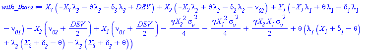

with_theta := X__3*(-X__3*lambda__3 - theta*lambda__3 - delta__3*lambda__3 + DEV) + X__2*(-X__2*lambda__2 + theta*lambda__2 - delta__2*lambda__2 - nu__02) + X__1*(-X__1*lambda__1 + theta*lambda__1 - delta__1*lambda__1 - nu__01) + X__2*(nu__02 + DEV/2) + X__1*(nu__01 + DEV/2) - gamma*X__2^2*sigma__v^2/4 - gamma*X__1^2*sigma__v^2/4 + gamma*X__2*X__1*sigma__v^2/2 + theta*(lambda__1*(X__1 + delta__1 - theta) + lambda__2*(X__2 + delta__2 - theta) - lambda__3*(X__3 + delta__3 + theta));
X__3*(-X__3*lambda__3-theta*lambda__3-delta__3*lambda__3+DEV)+X__2*(-X__2*lambda__2+theta*lambda__2-delta__2*lambda__2-nu__02)+X__1*(-X__1*lambda__1+theta*lambda__1-delta__1*lambda__1-nu__01)+X__2*(nu__02+(1/2)*DEV)+X__1*(nu__01+(1/2)*DEV)-(1/4)*gamma*X__2^2*sigma__v^2-(1/4)*gamma*X__1^2*sigma__v^2+(1/2)*gamma*X__2*X__1*sigma__v^2+theta*(lambda__1*(X__1+delta__1-theta)+lambda__2*(X__2+delta__2-theta)-lambda__3*(X__3+delta__3+theta))

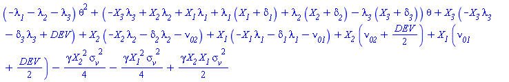

collect(with_theta, theta);
(-lambda__1-lambda__2-lambda__3)*theta^2+(-X__3*lambda__3+X__2*lambda__2+X__1*lambda__1+lambda__1*(X__1+delta__1)+lambda__2*(X__2+delta__2)-lambda__3*(X__3+delta__3))*theta+X__3*(-X__3*lambda__3-delta__3*lambda__3+DEV)+X__2*(-X__2*lambda__2-delta__2*lambda__2-nu__02)+X__1*(-X__1*lambda__1-delta__1*lambda__1-nu__01)+X__2*(nu__02+(1/2)*DEV)+X__1*(nu__01+(1/2)*DEV)-(1/4)*gamma*X__2^2*sigma__v^2-(1/4)*gamma*X__1^2*sigma__v^2+(1/2)*gamma*X__2*X__1*sigma__v^2

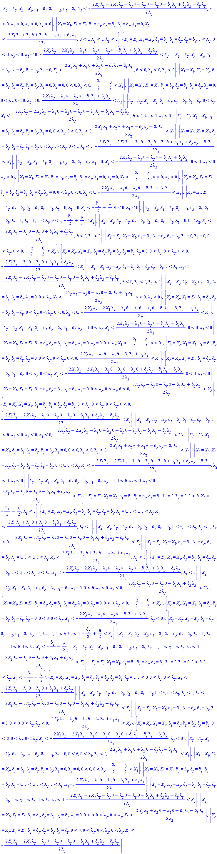

solve(difference_term<0);
Warning, solve may be ignoring assumptions on the input variables.
{X__2 = X__2, X__3 = X__3, delta__1 = delta__1, delta__2 = delta__2, delta__3 = delta__3, X__1 < -(1/2)*(2*X__2*lambda__2-2*X__3*lambda__3-lambda__1*theta-lambda__2*theta-lambda__3*theta+delta__1*lambda__1+delta__2*lambda__2-delta__3*lambda__3)/lambda__1, theta < 0, lambda__1 < 0, lambda__2 < 0, lambda__3 < 0}, {X__1 = X__1, X__3 = X__3, delta__1 = delta__1, delta__2 = delta__2, delta__3 = delta__3, lambda__1 = 0, X__2 < (1/2)*(2*X__3*lambda__3+lambda__2*theta+lambda__3*theta-delta__2*lambda__2+delta__3*lambda__3)/lambda__2, theta < 0, lambda__2 < 0, lambda__3 < 0}, {X__2 = X__2, X__3 = X__3, delta__1 = delta__1, delta__2 = delta__2, delta__3 = delta__3, 0 < lambda__1, theta < 0, lambda__2 < 0, lambda__3 < 0, -(1/2)*(2*X__2*lambda__2-2*X__3*lambda__3-lambda__1*theta-lambda__2*theta-lambda__3*theta+delta__1*lambda__1+delta__2*lambda__2-delta__3*lambda__3)/lambda__1 < X__1}, {X__2 = X__2, X__3 = X__3, delta__1 = delta__1, delta__2 = delta__2, delta__3 = delta__3, lambda__2 = 0, X__1 < (1/2)*(2*X__3*lambda__3+lambda__1*theta+lambda__3*theta-delta__1*lambda__1+delta__3*lambda__3)/lambda__1, theta < 0, lambda__1 < 0, lambda__3 < 0}, {X__1 = X__1, X__2 = X__2, delta__1 = delta__1, delta__2 = delta__2, delta__3 = delta__3, lambda__1 = 0, lambda__2 = 0, theta < 0, lambda__3 < 0, -(1/2)*delta__3-(1/2)*theta < X__3}, {X__2 = X__2, X__3 = X__3, delta__1 = delta__1, delta__2 = delta__2, delta__3 = delta__3, lambda__2 = 0, 0 < lambda__1, theta < 0, lambda__3 < 0, (1/2)*(2*X__3*lambda__3+lambda__1*theta+lambda__3*theta-delta__1*lambda__1+delta__3*lambda__3)/lambda__1 < X__1}, {X__2 = X__2, X__3 = X__3, delta__1 = delta__1, delta__2 = delta__2, delta__3 = delta__3, 0 < lambda__2, X__1 < -(1/2)*(2*X__2*lambda__2-2*X__3*lambda__3-lambda__1*theta-lambda__2*theta-lambda__3*theta+delta__1*lambda__1+delta__2*lambda__2-delta__3*lambda__3)/lambda__1, theta < 0, lambda__1 < 0, lambda__3 < 0}, {X__1 = X__1, X__3 = X__3, delta__1 = delta__1, delta__2 = delta__2, delta__3 = delta__3, lambda__1 = 0, 0 < lambda__2, theta < 0, lambda__3 < 0, (1/2)*(2*X__3*lambda__3+lambda__2*theta+lambda__3*theta-delta__2*lambda__2+delta__3*lambda__3)/lambda__2 < X__2}, {X__2 = X__2, X__3 = X__3, delta__1 = delta__1, delta__2 = delta__2, delta__3 = delta__3, 0 < lambda__1, 0 < lambda__2, theta < 0, lambda__3 < 0, -(1/2)*(2*X__2*lambda__2-2*X__3*lambda__3-lambda__1*theta-lambda__2*theta-lambda__3*theta+delta__1*lambda__1+delta__2*lambda__2-delta__3*lambda__3)/lambda__1 < X__1}, {X__2 = X__2, X__3 = X__3, delta__1 = delta__1, delta__2 = delta__2, delta__3 = delta__3, lambda__3 = 0, X__1 < -(1/2)*(2*X__2*lambda__2-lambda__1*theta-lambda__2*theta+delta__1*lambda__1+delta__2*lambda__2)/lambda__1, theta < 0, lambda__1 < 0, lambda__2 < 0}, {X__1 = X__1, X__3 = X__3, delta__1 = delta__1, delta__2 = delta__2, delta__3 = delta__3, lambda__1 = 0, lambda__3 = 0, X__2 < -(1/2)*delta__2+(1/2)*theta, theta < 0, lambda__2 < 0}, {X__2 = X__2, X__3 = X__3, delta__1 = delta__1, delta__2 = delta__2, delta__3 = delta__3, lambda__3 = 0, 0 < lambda__1, theta < 0, lambda__2 < 0, -(1/2)*(2*X__2*lambda__2-lambda__1*theta-lambda__2*theta+delta__1*lambda__1+delta__2*lambda__2)/lambda__1 < X__1}, {X__2 = X__2, X__3 = X__3, delta__1 = delta__1, delta__2 = delta__2, delta__3 = delta__3, lambda__2 = 0, lambda__3 = 0, X__1 < -(1/2)*delta__1+(1/2)*theta, theta < 0, lambda__1 < 0}, {X__2 = X__2, X__3 = X__3, delta__1 = delta__1, delta__2 = delta__2, delta__3 = delta__3, lambda__2 = 0, lambda__3 = 0, 0 < lambda__1, theta < 0, -(1/2)*delta__1+(1/2)*theta < X__1}, {X__2 = X__2, X__3 = X__3, delta__1 = delta__1, delta__2 = delta__2, delta__3 = delta__3, lambda__3 = 0, 0 < lambda__2, X__1 < -(1/2)*(2*X__2*lambda__2-lambda__1*theta-lambda__2*theta+delta__1*lambda__1+delta__2*lambda__2)/lambda__1, theta < 0, lambda__1 < 0}, {X__1 = X__1, X__3 = X__3, delta__1 = delta__1, delta__2 = delta__2, delta__3 = delta__3, lambda__1 = 0, lambda__3 = 0, 0 < lambda__2, theta < 0, -(1/2)*delta__2+(1/2)*theta < X__2}, {X__2 = X__2, X__3 = X__3, delta__1 = delta__1, delta__2 = delta__2, delta__3 = delta__3, lambda__3 = 0, 0 < lambda__1, 0 < lambda__2, theta < 0, -(1/2)*(2*X__2*lambda__2-lambda__1*theta-lambda__2*theta+delta__1*lambda__1+delta__2*lambda__2)/lambda__1 < X__1}, {X__2 = X__2, X__3 = X__3, delta__1 = delta__1, delta__2 = delta__2, delta__3 = delta__3, 0 < lambda__3, X__1 < -(1/2)*(2*X__2*lambda__2-2*X__3*lambda__3-lambda__1*theta-lambda__2*theta-lambda__3*theta+delta__1*lambda__1+delta__2*lambda__2-delta__3*lambda__3)/lambda__1, theta < 0, lambda__1 < 0, lambda__2 < 0}, {X__1 = X__1, X__3 = X__3, delta__1 = delta__1, delta__2 = delta__2, delta__3 = delta__3, lambda__1 = 0, 0 < lambda__3, X__2 < (1/2)*(2*X__3*lambda__3+lambda__2*theta+lambda__3*theta-delta__2*lambda__2+delta__3*lambda__3)/lambda__2, theta < 0, lambda__2 < 0}, {X__2 = X__2, X__3 = X__3, delta__1 = delta__1, delta__2 = delta__2, delta__3 = delta__3, 0 < lambda__1, 0 < lambda__3, theta < 0, lambda__2 < 0, -(1/2)*(2*X__2*lambda__2-2*X__3*lambda__3-lambda__1*theta-lambda__2*theta-lambda__3*theta+delta__1*lambda__1+delta__2*lambda__2-delta__3*lambda__3)/lambda__1 < X__1}, {X__2 = X__2, X__3 = X__3, delta__1 = delta__1, delta__2 = delta__2, delta__3 = delta__3, lambda__2 = 0, 0 < lambda__3, X__1 < (1/2)*(2*X__3*lambda__3+lambda__1*theta+lambda__3*theta-delta__1*lambda__1+delta__3*lambda__3)/lambda__1, theta < 0, lambda__1 < 0}, {X__1 = X__1, X__2 = X__2, delta__1 = delta__1, delta__2 = delta__2, delta__3 = delta__3, lambda__1 = 0, lambda__2 = 0, 0 < lambda__3, X__3 < -(1/2)*delta__3-(1/2)*theta, theta < 0}, {X__2 = X__2, X__3 = X__3, delta__1 = delta__1, delta__2 = delta__2, delta__3 = delta__3, lambda__2 = 0, 0 < lambda__1, 0 < lambda__3, theta < 0, (1/2)*(2*X__3*lambda__3+lambda__1*theta+lambda__3*theta-delta__1*lambda__1+delta__3*lambda__3)/lambda__1 < X__1}, {X__2 = X__2, X__3 = X__3, delta__1 = delta__1, delta__2 = delta__2, delta__3 = delta__3, 0 < lambda__2, 0 < lambda__3, X__1 < -(1/2)*(2*X__2*lambda__2-2*X__3*lambda__3-lambda__1*theta-lambda__2*theta-lambda__3*theta+delta__1*lambda__1+delta__2*lambda__2-delta__3*lambda__3)/lambda__1, theta < 0, lambda__1 < 0}, {X__1 = X__1, X__3 = X__3, delta__1 = delta__1, delta__2 = delta__2, delta__3 = delta__3, lambda__1 = 0, 0 < lambda__2, 0 < lambda__3, theta < 0, (1/2)*(2*X__3*lambda__3+lambda__2*theta+lambda__3*theta-delta__2*lambda__2+delta__3*lambda__3)/lambda__2 < X__2}, {X__2 = X__2, X__3 = X__3, delta__1 = delta__1, delta__2 = delta__2, delta__3 = delta__3, 0 < lambda__1, 0 < lambda__2, 0 < lambda__3, theta < 0, -(1/2)*(2*X__2*lambda__2-2*X__3*lambda__3-lambda__1*theta-lambda__2*theta-lambda__3*theta+delta__1*lambda__1+delta__2*lambda__2-delta__3*lambda__3)/lambda__1 < X__1}, {X__2 = X__2, X__3 = X__3, delta__1 = delta__1, delta__2 = delta__2, delta__3 = delta__3, 0 < theta, lambda__1 < 0, lambda__2 < 0, lambda__3 < 0, -(1/2)*(2*X__2*lambda__2-2*X__3*lambda__3-lambda__1*theta-lambda__2*theta-lambda__3*theta+delta__1*lambda__1+delta__2*lambda__2-delta__3*lambda__3)/lambda__1 < X__1}, {X__1 = X__1, X__3 = X__3, delta__1 = delta__1, delta__2 = delta__2, delta__3 = delta__3, lambda__1 = 0, 0 < theta, lambda__2 < 0, lambda__3 < 0, (1/2)*(2*X__3*lambda__3+lambda__2*theta+lambda__3*theta-delta__2*lambda__2+delta__3*lambda__3)/lambda__2 < X__2}, {X__2 = X__2, X__3 = X__3, delta__1 = delta__1, delta__2 = delta__2, delta__3 = delta__3, 0 < theta, 0 < lambda__1, X__1 < -(1/2)*(2*X__2*lambda__2-2*X__3*lambda__3-lambda__1*theta-lambda__2*theta-lambda__3*theta+delta__1*lambda__1+delta__2*lambda__2-delta__3*lambda__3)/lambda__1, lambda__2 < 0, lambda__3 < 0}, {X__2 = X__2, X__3 = X__3, delta__1 = delta__1, delta__2 = delta__2, delta__3 = delta__3, lambda__2 = 0, 0 < theta, lambda__1 < 0, lambda__3 < 0, (1/2)*(2*X__3*lambda__3+lambda__1*theta+lambda__3*theta-delta__1*lambda__1+delta__3*lambda__3)/lambda__1 < X__1}, {X__1 = X__1, X__2 = X__2, delta__1 = delta__1, delta__2 = delta__2, delta__3 = delta__3, lambda__1 = 0, lambda__2 = 0, 0 < theta, X__3 < -(1/2)*delta__3-(1/2)*theta, lambda__3 < 0}, {X__2 = X__2, X__3 = X__3, delta__1 = delta__1, delta__2 = delta__2, delta__3 = delta__3, lambda__2 = 0, 0 < theta, 0 < lambda__1, X__1 < (1/2)*(2*X__3*lambda__3+lambda__1*theta+lambda__3*theta-delta__1*lambda__1+delta__3*lambda__3)/lambda__1, lambda__3 < 0}, {X__2 = X__2, X__3 = X__3, delta__1 = delta__1, delta__2 = delta__2, delta__3 = delta__3, 0 < theta, 0 < lambda__2, lambda__1 < 0, lambda__3 < 0, -(1/2)*(2*X__2*lambda__2-2*X__3*lambda__3-lambda__1*theta-lambda__2*theta-lambda__3*theta+delta__1*lambda__1+delta__2*lambda__2-delta__3*lambda__3)/lambda__1 < X__1}, {X__1 = X__1, X__3 = X__3, delta__1 = delta__1, delta__2 = delta__2, delta__3 = delta__3, lambda__1 = 0, 0 < theta, 0 < lambda__2, X__2 < (1/2)*(2*X__3*lambda__3+lambda__2*theta+lambda__3*theta-delta__2*lambda__2+delta__3*lambda__3)/lambda__2, lambda__3 < 0}, {X__2 = X__2, X__3 = X__3, delta__1 = delta__1, delta__2 = delta__2, delta__3 = delta__3, 0 < theta, 0 < lambda__1, 0 < lambda__2, X__1 < -(1/2)*(2*X__2*lambda__2-2*X__3*lambda__3-lambda__1*theta-lambda__2*theta-lambda__3*theta+delta__1*lambda__1+delta__2*lambda__2-delta__3*lambda__3)/lambda__1, lambda__3 < 0}, {X__2 = X__2, X__3 = X__3, delta__1 = delta__1, delta__2 = delta__2, delta__3 = delta__3, lambda__3 = 0, 0 < theta, lambda__1 < 0, lambda__2 < 0, -(1/2)*(2*X__2*lambda__2-lambda__1*theta-lambda__2*theta+delta__1*lambda__1+delta__2*lambda__2)/lambda__1 < X__1}, {X__1 = X__1, X__3 = X__3, delta__1 = delta__1, delta__2 = delta__2, delta__3 = delta__3, lambda__1 = 0, lambda__3 = 0, 0 < theta, lambda__2 < 0, -(1/2)*delta__2+(1/2)*theta < X__2}, {X__2 = X__2, X__3 = X__3, delta__1 = delta__1, delta__2 = delta__2, delta__3 = delta__3, lambda__3 = 0, 0 < theta, 0 < lambda__1, X__1 < -(1/2)*(2*X__2*lambda__2-lambda__1*theta-lambda__2*theta+delta__1*lambda__1+delta__2*lambda__2)/lambda__1, lambda__2 < 0}, {X__2 = X__2, X__3 = X__3, delta__1 = delta__1, delta__2 = delta__2, delta__3 = delta__3, lambda__2 = 0, lambda__3 = 0, 0 < theta, lambda__1 < 0, -(1/2)*delta__1+(1/2)*theta < X__1}, {X__2 = X__2, X__3 = X__3, delta__1 = delta__1, delta__2 = delta__2, delta__3 = delta__3, lambda__2 = 0, lambda__3 = 0, 0 < theta, 0 < lambda__1, X__1 < -(1/2)*delta__1+(1/2)*theta}, {X__2 = X__2, X__3 = X__3, delta__1 = delta__1, delta__2 = delta__2, delta__3 = delta__3, lambda__3 = 0, 0 < theta, 0 < lambda__2, lambda__1 < 0, -(1/2)*(2*X__2*lambda__2-lambda__1*theta-lambda__2*theta+delta__1*lambda__1+delta__2*lambda__2)/lambda__1 < X__1}, {X__1 = X__1, X__3 = X__3, delta__1 = delta__1, delta__2 = delta__2, delta__3 = delta__3, lambda__1 = 0, lambda__3 = 0, 0 < theta, 0 < lambda__2, X__2 < -(1/2)*delta__2+(1/2)*theta}, {X__2 = X__2, X__3 = X__3, delta__1 = delta__1, delta__2 = delta__2, delta__3 = delta__3, lambda__3 = 0, 0 < theta, 0 < lambda__1, 0 < lambda__2, X__1 < -(1/2)*(2*X__2*lambda__2-lambda__1*theta-lambda__2*theta+delta__1*lambda__1+delta__2*lambda__2)/lambda__1}, {X__2 = X__2, X__3 = X__3, delta__1 = delta__1, delta__2 = delta__2, delta__3 = delta__3, 0 < theta, 0 < lambda__3, lambda__1 < 0, lambda__2 < 0, -(1/2)*(2*X__2*lambda__2-2*X__3*lambda__3-lambda__1*theta-lambda__2*theta-lambda__3*theta+delta__1*lambda__1+delta__2*lambda__2-delta__3*lambda__3)/lambda__1 < X__1}, {X__1 = X__1, X__3 = X__3, delta__1 = delta__1, delta__2 = delta__2, delta__3 = delta__3, lambda__1 = 0, 0 < theta, 0 < lambda__3, lambda__2 < 0, (1/2)*(2*X__3*lambda__3+lambda__2*theta+lambda__3*theta-delta__2*lambda__2+delta__3*lambda__3)/lambda__2 < X__2}, {X__2 = X__2, X__3 = X__3, delta__1 = delta__1, delta__2 = delta__2, delta__3 = delta__3, 0 < theta, 0 < lambda__1, 0 < lambda__3, X__1 < -(1/2)*(2*X__2*lambda__2-2*X__3*lambda__3-lambda__1*theta-lambda__2*theta-lambda__3*theta+delta__1*lambda__1+delta__2*lambda__2-delta__3*lambda__3)/lambda__1, lambda__2 < 0}, {X__2 = X__2, X__3 = X__3, delta__1 = delta__1, delta__2 = delta__2, delta__3 = delta__3, lambda__2 = 0, 0 < theta, 0 < lambda__3, lambda__1 < 0, (1/2)*(2*X__3*lambda__3+lambda__1*theta+lambda__3*theta-delta__1*lambda__1+delta__3*lambda__3)/lambda__1 < X__1}, {X__1 = X__1, X__2 = X__2, delta__1 = delta__1, delta__2 = delta__2, delta__3 = delta__3, lambda__1 = 0, lambda__2 = 0, 0 < theta, 0 < lambda__3, -(1/2)*delta__3-(1/2)*theta < X__3}, {X__2 = X__2, X__3 = X__3, delta__1 = delta__1, delta__2 = delta__2, delta__3 = delta__3, lambda__2 = 0, 0 < theta, 0 < lambda__1, 0 < lambda__3, X__1 < (1/2)*(2*X__3*lambda__3+lambda__1*theta+lambda__3*theta-delta__1*lambda__1+delta__3*lambda__3)/lambda__1}, {X__2 = X__2, X__3 = X__3, delta__1 = delta__1, delta__2 = delta__2, delta__3 = delta__3, 0 < theta, 0 < lambda__2, 0 < lambda__3, lambda__1 < 0, -(1/2)*(2*X__2*lambda__2-2*X__3*lambda__3-lambda__1*theta-lambda__2*theta-lambda__3*theta+delta__1*lambda__1+delta__2*lambda__2-delta__3*lambda__3)/lambda__1 < X__1}, {X__1 = X__1, X__3 = X__3, delta__1 = delta__1, delta__2 = delta__2, delta__3 = delta__3, lambda__1 = 0, 0 < theta, 0 < lambda__2, 0 < lambda__3, X__2 < (1/2)*(2*X__3*lambda__3+lambda__2*theta+lambda__3*theta-delta__2*lambda__2+delta__3*lambda__3)/lambda__2}, {X__2 = X__2, X__3 = X__3, delta__1 = delta__1, delta__2 = delta__2, delta__3 = delta__3, 0 < theta, 0 < lambda__1, 0 < lambda__2, 0 < lambda__3, X__1 < -(1/2)*(2*X__2*lambda__2-2*X__3*lambda__3-lambda__1*theta-lambda__2*theta-lambda__3*theta+delta__1*lambda__1+delta__2*lambda__2-delta__3*lambda__3)/lambda__1}
