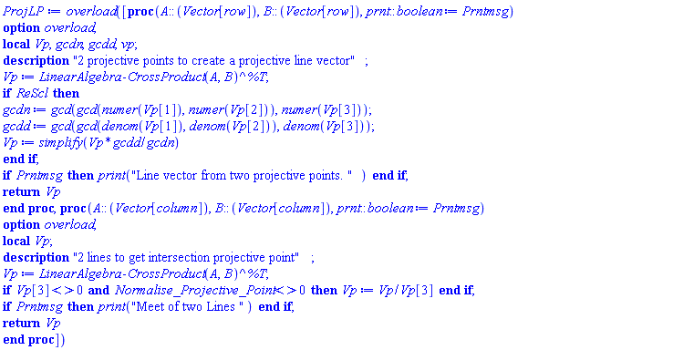

Question: ReScaliing a projective vector
I want to rescale a projective vector. Have been using gcd on the numerators and denominators. This works in simple situations. It doesn;t work well here, admitadely the points have been just made up for the question.  Square roots seem to make it mal-preform. I run into a lot of squate roots in symbolic situations. What would be a better way? I have been wondering if frontend would help?

ProjLP:=overload([
      proc(A::Vector[row],B::Vector[row],prnt::boolean:=Prntmsg)
      description "2 projective points to create a projective line vector";
      option overload;
      local Vp ,gcdn,gcdd,vp ;
      uses LinearAlgebra;
      Vp:=CrossProduct(A,B)^%T;#print("2nd ",Vp);
      if ReScl then
         gcdn := gcd(gcd(numer(Vp[1]),numer(Vp[2])), numer(Vp[3]));
         gcdd := gcd(gcd(denom(Vp[1]),denom(Vp[2])), denom(Vp[3]));
         Vp:=simplify(Vp*gcdd/gcdn);
      end if;
      if Prntmsg then
         print("Line vector from two projective points. " );
      end if;
      return Vp
      end proc,
      proc(A::Vector[column],B::Vector[column],prnt::boolean:=Prntmsg)
      description "2 lines to get intersection projective point";
      option overload;
      uses LinearAlgebra;
      local  Vp;
      if Vp[3]<>0 and Normalise_Projective_Point<>0 then
           Vp:=Vp/Vp[3];
      end if;
      if Prntmsg then
           print("Meet of two Lines ");
      end if;
      return Vp
   end proc
proc () option overload; [proc (A::(Vector[row]), B::(Vector[row]), prnt::boolean := Prntmsg) local Vp, gcdn, gcdd, vp; option overload; description "2 projective points to create a projective line vector"; Vp := LinearAlgebra:-CrossProduct(A, B)^%T; if ReScl then gcdn := gcd(gcd(numer(Vp[1]), numer(Vp[2])), numer(Vp[3])); gcdd := gcd(gcd(denom(Vp[1]), denom(Vp[2])), denom(Vp[3])); Vp := simplify(Vp*gcdd/gcdn) end if; if Prntmsg then print("Line vector from two projective points. ") end if; return Vp end proc, proc (A::(Vector[column]), B::(Vector[column]), prnt::boolean := Prntmsg) local Vp; option overload; description "2 lines to get intersection projective point"; Vp := LinearAlgebra:-CrossProduct(A, B)^%T; if Vp[3] <> 0 and Normalise_Projective_Point <> 0 then Vp := Vp/Vp[3] end if; if Prntmsg then print("Meet of two Lines ") end if; return Vp end proc] end proc
