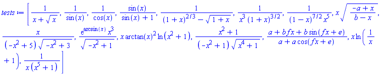

tests:=[1/(x+sqrt(x)),1/(sin(x)),1/(cos(x)),sin(x)/(sin(x)+1),1/((1+x)^(2/3)-(1+x)^(1/2)),1/x^3/(1+x)^(3/2),1/(1-x)^(7/2)/x^5,x*((-a+x)/(b-x))^(1/2),x/(-x^2+5)/(-x^2+3)^(1/2),exp(arcsin(x))*x^3/(-x^2+1)^(1/2),x*arctan(x)^2*ln(x^2+1),(x^2+1)/(-x^2+1)/(x^4+1)^(1/2),(a+b*f*x+b*sin(f*x+e))/(a+a*cos(f*x+e)),x*ln(1/x+1),1/x/(x^5+1)];

[1/(x+x^(1/2)), 1/sin(x), 1/cos(x), sin(x)/(sin(x)+1), 1/((1+x)^(2/3)-(1+x)^(1/2)), 1/(x^3*(1+x)^(3/2)), 1/((1-x)^(7/2)*x^5), x*((-a+x)/(b-x))^(1/2), x/((-x^2+5)*(-x^2+3)^(1/2)), exp(arcsin(x))*x^3/(-x^2+1)^(1/2), x*arctan(x)^2*ln(x^2+1), (x^2+1)/((-x^2+1)*(x^4+1)^(1/2)), (a+b*f*x+b*sin(f*x+e))/(a+a*cos(f*x+e)), x*ln(1/x+1), 1/(x*(x^5+1))]

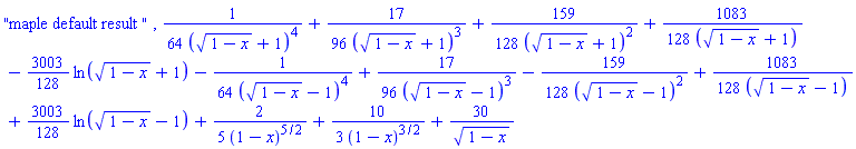

integral", Int(1/((1-x)^(7/2)*x^5), x)
"maple default result ", (1/64)/((1-x)^(1/2)+1)^4+(17/96)/((1-x)^(1/2)+1)^3+(159/128)/((1-x)^(1/2)+1)^2+(1083/128)/((1-x)^(1/2)+1)-(3003/128)*ln((1-x)^(1/2)+1)-(1/64)/((1-x)^(1/2)-1)^4+(17/96)/((1-x)^(1/2)-1)^3-(159/128)/((1-x)^(1/2)-1)^2+(1083/128)/((1-x)^(1/2)-1)+(3003/128)*ln((1-x)^(1/2)-1)+(2/5)/(1-x)^(5/2)+(10/3)/(1-x)^(3/2)+30/(1-x)^(1/2)
"smart int result ", (1/960)*(45045*x^6-105105*x^5+69069*x^4-6435*x^3-1430*x^2-520*x-240)/((x-1)^2*(1-x)^(1/2)*x^4)-(3003/64)*arctanh((1-x)^(1/2))
"smart int percentage size relative to default ", "37.18"
