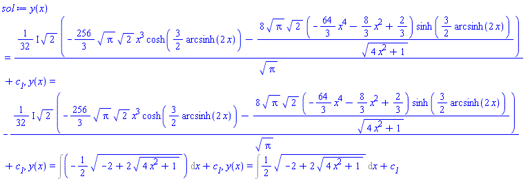

ode:=x = diff(y(x), x)*sqrt(1 + diff(y(x), x)^2);
x = (diff(y(x), x))*(1+(diff(y(x), x))^2)^(1/2)
sol:=dsolve(ode);

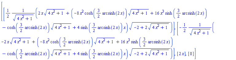

map(X->[odetest(X,ode) assuming x>0],[sol])
y(x) = ((1/32)*I)*2^(1/2)*(-(256/3)*Pi^(1/2)*2^(1/2)*x^3*cosh((3/2)*arcsinh(2*x))-8*Pi^(1/2)*2^(1/2)*(-(64/3)*x^4-(8/3)*x^2+2/3)*sinh((3/2)*arcsinh(2*x))/(4*x^2+1)^(1/2))/Pi^(1/2)+c__1, y(x) = -((1/32)*I)*2^(1/2)*(-(256/3)*Pi^(1/2)*2^(1/2)*x^3*cosh((3/2)*arcsinh(2*x))-8*Pi^(1/2)*2^(1/2)*(-(64/3)*x^4-(8/3)*x^2+2/3)*sinh((3/2)*arcsinh(2*x))/(4*x^2+1)^(1/2))/Pi^(1/2)+c__1, y(x) = Int(-(1/2)*(-2+2*(4*x^2+1)^(1/2))^(1/2), x)+c__1, y(x) = Int((1/2)*(-2+2*(4*x^2+1)^(1/2))^(1/2), x)+c__1
[[(1/2)*(2*x*(4*x^2+1)^(1/2)+(-8*x^2*cosh((3/2)*arcsinh(2*x))*(4*x^2+1)^(1/2)+16*x^3*sinh((3/2)*arcsinh(2*x))-cosh((3/2)*arcsinh(2*x))*(4*x^2+1)^(1/2)+4*sinh((3/2)*arcsinh(2*x))*x)*(-2+2*(4*x^2+1)^(1/2))^(1/2))/(4*x^2+1)^(1/2)], [-(1/2)*(-2*x*(4*x^2+1)^(1/2)+(-8*x^2*cosh((3/2)*arcsinh(2*x))*(4*x^2+1)^(1/2)+16*x^3*sinh((3/2)*arcsinh(2*x))-cosh((3/2)*arcsinh(2*x))*(4*x^2+1)^(1/2)+4*sinh((3/2)*arcsinh(2*x))*x)*(-2+2*(4*x^2+1)^(1/2))^(1/2))/(4*x^2+1)^(1/2)], [2*x], [0]]
