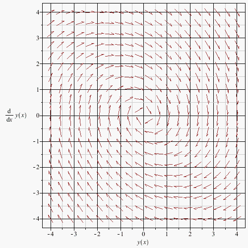

For display of plot axes labels, I prefer to use the Typesseting in place so that diff(y(x),x) display as y'(x) (takes less space and looks better also).
It does that in the worksheet. But when using diff(y(x),x) as the Y axis label, the plot still shows diff(y(x),x) and not y'(x).
Is there a way to make plot and DEtools:-DEplot  use the Typesetting in place?   What is the point of using Typesetting if plots generated do not use it?

#phase plot for second order ode. Y axis is y'(x) and X axis is y(x)
#uses DynamicsSystems for conversion.
ode := diff(y(x),x$2) = -y(x)-1/2*diff(y(x),x);
DynamicSystems:-SystemOptions('statevariable'=sv):
DynamicSystems:-SystemOptions('discretefreqvar'=ssv):
DynamicSystems:-SystemOptions('outputvariable'=sssv):
DynamicSystems:-SystemOptions('continuoustimevar'=ssssv):
DynamicSystems:-SystemOptions('continuoustimevar'=x):
sys:=DynamicSystems:-DiffEquation(ode,'outputvariable'=[y(x)]):
sys0:=DynamicSystems:-StateSpace(sys):
eq1:=diff(X1(x),x)=sys0:-a[1,..].Vector([X1(x),X2(x)]):
eq2:=diff(X2(x),x)=sys0:-a[2,..].Vector([X1(x),X2(x)]):
DEtools:-DEplot([eq1,eq2],[X1(x),X2(x)],x=0..100,
            X2=-4..4,X1=-4..4,
            axes=boxed,
            linecolor = red,
            labels=[y(x),diff(y(x),x)]);

Notice the label on Y axis above. I'd like that to display as y'(x) as it is in the worksheet.
