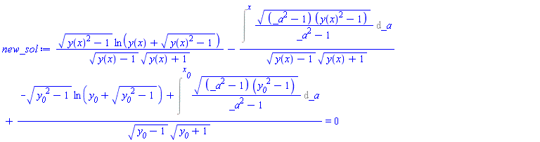

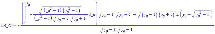

Update
If we solve the ODE first with no IC, and then manually solve for C and plug this back into the Maple solution then it works and Maple odetest verifies the solution. So no need for assuming x0>1 ?

sol_C:=solve(eq,_C1);
((y(x)-1)*(y(x)+1))^(1/2)*ln(y(x)+(y(x)^2-1)^(1/2))/((y(x)-1)^(1/2)*(y(x)+1)^(1/2))+Intat(-((_a^2-1)*(y(x)^2-1))^(1/2)/((_a^2-1)*(y(x)-1)^(1/2)*(y(x)+1)^(1/2)), _a = x)+c__1 = 0
((y__0-1)*(y__0+1))^(1/2)*ln(y__0+(y__0^2-1)^(1/2))/((y__0-1)^(1/2)*(y__0+1)^(1/2))+Intat(-((_a^2-1)*(y__0^2-1))^(1/2)/((_a^2-1)*(y__0-1)^(1/2)*(y__0+1)^(1/2)), _a = x__0)+c__1 = 0
-(Intat(-((_a^2-1)*(y__0^2-1))^(1/2)/((_a^2-1)*(y__0-1)^(1/2)*(y__0+1)^(1/2)), _a = x__0)*(y__0-1)^(1/2)*(y__0+1)^(1/2)+((y__0-1)*(y__0+1))^(1/2)*ln(y__0+(y__0^2-1)^(1/2)))/((y__0-1)^(1/2)*(y__0+1)^(1/2))
new_sol:=simplify(eval(maple_sol_no_IC,_C1=sol_C));
(y(x)^2-1)^(1/2)*ln(y(x)+(y(x)^2-1)^(1/2))/((y(x)-1)^(1/2)*(y(x)+1)^(1/2))-Intat(((_a^2-1)*(y(x)^2-1))^(1/2)/(_a^2-1), _a = x)/((y(x)-1)^(1/2)*(y(x)+1)^(1/2))+(-(y__0^2-1)^(1/2)*ln(y__0+(y__0^2-1)^(1/2))+Intat(((_a^2-1)*(y__0^2-1))^(1/2)/(_a^2-1), _a = x__0))/((y__0-1)^(1/2)*(y__0+1)^(1/2)) = 0
odetest(new_sol,[ode,IC])
[0, 0]
