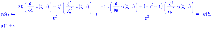

Hello, I am having problem in solving the pde in the image using maple. Due to its nonlinear nature it has been solved for small value of v using first order perturbation technique and seperation of variable method into radial and angular part in many papers. I am having trouble in proceeding as Maple complains about Boundary/Initial condition.Please tell me if Maple can provide any help in improving existing solution or providing new solution? I can post the full solution procedure by the method i mentioned if needed.

pde1 := (diff(xi^2*(diff(psi(xi, mu), xi)), xi))/xi^2+(diff((-mu^2+1)*(diff(psi(xi, mu), mu)), mu))/xi^2 = -psi(xi, mu)^n+v
(2*xi*(diff(psi(xi, mu), xi))+xi^2*(diff(diff(psi(xi, mu), xi), xi)))/xi^2+(-2*mu*(diff(psi(xi, mu), mu))+(-mu^2+1)*(diff(diff(psi(xi, mu), mu), mu)))/xi^2 = -psi(xi, mu)^n+v
bc1 := psi(0, mu) = 1, (D[1](psi))(0, mu) = 0, (D[2](psi))(0, mu) = 0, limit(psi(xi, mu), v = 0) = rhs(base)
psi(0, mu) = 1, (D[1](psi))(0, mu) = 0, (D[2](psi))(0, mu) = 0, psi(xi, mu) = series(1-(1/6)*xi^2+((1/120)*n)*xi^4+O(xi^6),xi,6)
pdsolve(pde1, [bc1], psi(xi, mu))
Error, (in pdsolve/sys) too many arguments; some or all of the following are wrong: [[psi(xi,mu)], [psi(0,mu) = 1, D[1](psi)(0,mu) = 0, D[2](psi)(0,mu) = 0, psi(xi,mu) = series(1-1/6*xi^2+1/120*n*xi^4+O(xi^6),xi,6)]]
