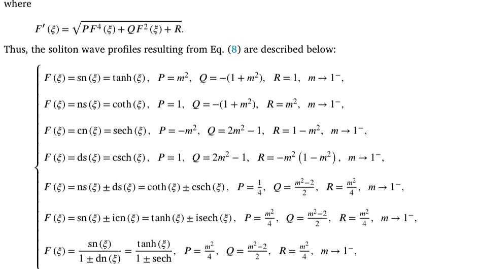

In many papers, I've noticed that the solution to an ODE (ordinary differential equation) often emerges directly when there's only a single function involved. My question is: is there a way to generate solutions to an ODE by producing specific parameters?

S := diff(F(xi), xi) = sqrt(P*F(xi)^4+Q*F(xi)^2+R)
diff(F(xi), xi) = (P*F(xi)^4+Q*F(xi)^2+R)^(1/2)

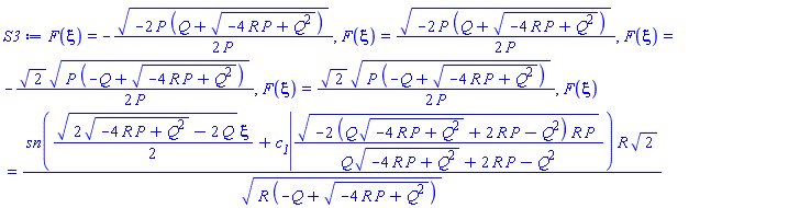

S3 := dsolve(S2, F(xi))
F(xi) = -(1/2)*(-2*P*(Q+(-4*P*R+Q^2)^(1/2)))^(1/2)/P, F(xi) = (1/2)*(-2*P*(Q+(-4*P*R+Q^2)^(1/2)))^(1/2)/P, F(xi) = -(1/2)*2^(1/2)*(P*(-Q+(-4*P*R+Q^2)^(1/2)))^(1/2)/P, F(xi) = (1/2)*2^(1/2)*(P*(-Q+(-4*P*R+Q^2)^(1/2)))^(1/2)/P, F(xi) = JacobiSN((1/2)*(2*(-4*P*R+Q^2)^(1/2)-2*Q)^(1/2)*xi+c__1, (-2*(Q*(-4*P*R+Q^2)^(1/2)+2*R*P-Q^2)*R*P)^(1/2)/(Q*(-4*P*R+Q^2)^(1/2)+2*R*P-Q^2))*R*2^(1/2)/(R*(-Q+(-4*P*R+Q^2)^(1/2)))^(1/2)
