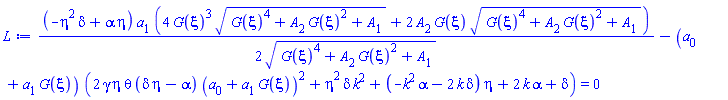

L := eval(Fode, {K, K1, K2})
(1/2)*(-delta*eta^2+alpha*eta)*a[1]*(4*G(xi)^3*(G(xi)^4+A[2]*G(xi)^2+A[1])^(1/2)+2*A[2]*G(xi)*(G(xi)^4+A[2]*G(xi)^2+A[1])^(1/2))/(G(xi)^4+A[2]*G(xi)^2+A[1])^(1/2)-(a[0]+a[1]*G(xi))*(2*gamma*eta*theta*(delta*eta-alpha)*(a[0]+a[1]*G(xi))^2+eta^2*delta*k^2+(-alpha*k^2-2*delta*k)*eta+2*k*alpha+delta) = 0

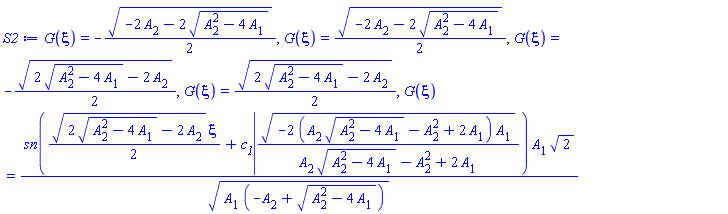

S2 := dsolve(S, G(xi))
G(xi) = -(1/2)*(-2*A[2]-2*(A[2]^2-4*A[1])^(1/2))^(1/2), G(xi) = (1/2)*(-2*A[2]-2*(A[2]^2-4*A[1])^(1/2))^(1/2), G(xi) = -(1/2)*(2*(A[2]^2-4*A[1])^(1/2)-2*A[2])^(1/2), G(xi) = (1/2)*(2*(A[2]^2-4*A[1])^(1/2)-2*A[2])^(1/2), G(xi) = JacobiSN((1/2)*(2*(A[2]^2-4*A[1])^(1/2)-2*A[2])^(1/2)*xi+c__1, (-2*(A[2]*(A[2]^2-4*A[1])^(1/2)-A[2]^2+2*A[1])*A[1])^(1/2)/(A[2]*(A[2]^2-4*A[1])^(1/2)-A[2]^2+2*A[1]))*A[1]*2^(1/2)/(A[1]*(-A[2]+(A[2]^2-4*A[1])^(1/2)))^(1/2)

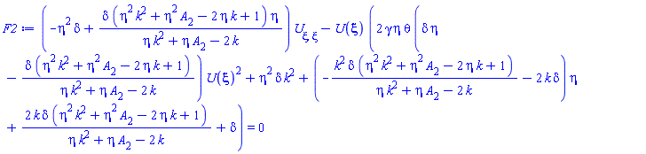

F2 := subs(case1, Fode)
(-eta^2*delta+delta*(eta^2*k^2+eta^2*A[2]-2*eta*k+1)*eta/(eta*k^2+eta*A[2]-2*k))*(diff(diff(U(xi), xi), xi))-U(xi)*(2*gamma*eta*theta*(delta*eta-delta*(eta^2*k^2+eta^2*A[2]-2*eta*k+1)/(eta*k^2+eta*A[2]-2*k))*U(xi)^2+eta^2*delta*k^2+(-k^2*delta*(eta^2*k^2+eta^2*A[2]-2*eta*k+1)/(eta*k^2+eta*A[2]-2*k)-2*k*delta)*eta+2*k*delta*(eta^2*k^2+eta^2*A[2]-2*eta*k+1)/(eta*k^2+eta*A[2]-2*k)+delta) = 0

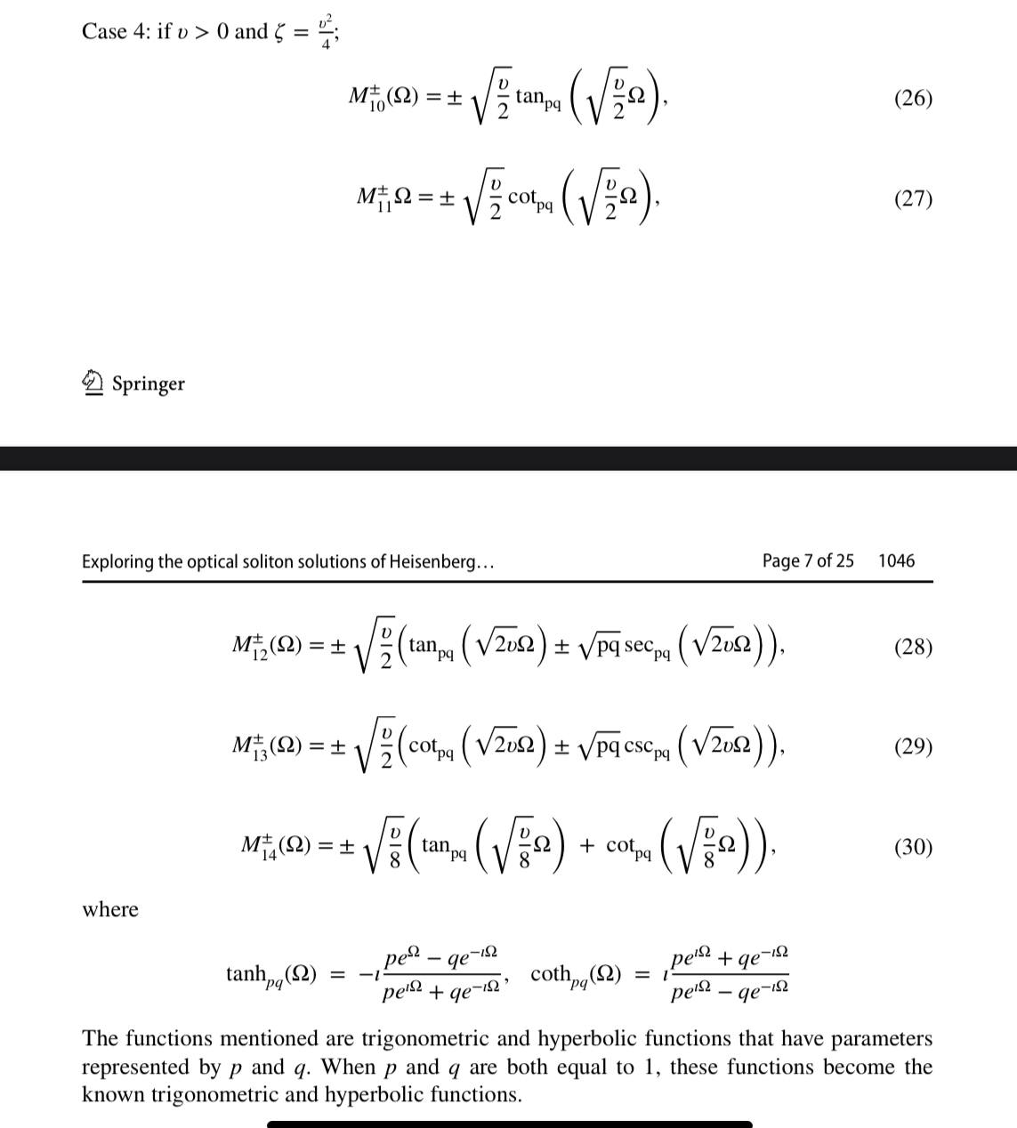

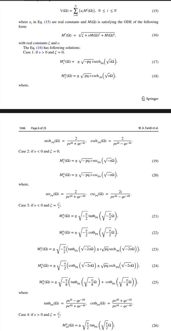

and i hope mapleprimes don't delete this question becuase of this pictures also it help for undrestanding
there is other picture for different auxilary equation just  add one multiply term for G(xi)^4 in case anyone needed i will upload
