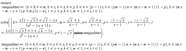

restart; inequalities := {0 < k, 0 < m, 0 < s, 0 < x, 0 < y, 0 < n+(p-1)*s, 0 < (m*y-1)*n+(m*x-m+1)*(1-p), 0 < (m*x-m-s+1)*p+m*y*(s-n), 1 < x+y, k < 1, m < 1, s < t, t < 1}; solve(`union`({k = (x*(1-sqrt(x))+sqrt(x)-2*x)/((x^2-3*x+1)*x), m = (sqrt(x)+x)/(x-1), n = (sqrt(x)+x)/(x-1), p = (-1-sqrt(x))/(x-1), s = (-1-sqrt(x))/(x-1), t = (2*x*(1-sqrt(x))+1+sqrt(x)-5*x)/(x^2-3*x+1), y = 1-sqrt(x)}, inequalities)); inequalities := {0 < k, 0 < m, 0 < s, 0 < x, 0 < y, 0 < n+(p-1)*s, 0 < (m*y-1)*n+(m*x-m+1)*(1-p), 0 < (m*x-m-s+1)*p+m*y*(s-n), 1 < x+y, k < 1, m < 1, s < t, t < 1}
Error, (in unknown) invalid input: SolveTools:-Inequality expects its 1st argument, eqns, to be of type {list, set}({`<`, `<=`, `=`}), but received [p < 1, -p < 0, And(2*argument((p-1)/p) <= Pi,-Pi < 2*argument((p-1)/p))]

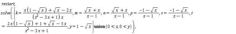

restart; solve(`union`({k = (x*(1-sqrt(x))+sqrt(x)-2*x)/((x^2-3*x+1)*x), m = (sqrt(x)+x)/(x-1), n = (sqrt(x)+x)/(x-1), p = (-1-sqrt(x))/(x-1), s = (-1-sqrt(x))/(x-1), t = (2*x*(1-sqrt(x))+1+sqrt(x)-5*x)/(x^2-3*x+1), y = 1-sqrt(x)}, {0 < x, 0 < y}))

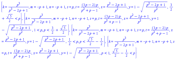

{k = p^3/(p^3-2*p+1), m = -p+1, n = -p+1, s = p, t = (3*p-2)*p/(p^2+p-1), x = (p^2-2*p+1)/p^2, y = 1-((p^2-2*p+1)/p^2)^(1/2), 3/2+(1/2)*5^(1/2) < p}, {k = p^3/(p^3-2*p+1), m = -p+1, n = -p+1, s = p, t = (3*p-2)*p/(p^2+p-1), x = (p^2-2*p+1)/p^2, y = 1-((p^2-2*p+1)/p^2)^(1/2), 1 < p, p < 3/2+(1/2)*5^(1/2)}, {k = p^3/(p^3-2*p+1), m = -p+1, n = -p+1, s = p, t = (3*p-2)*p/(p^2+p-1), x = (p^2-2*p+1)/p^2, y = 1-((p^2-2*p+1)/p^2)^(1/2), 1/2 < p, p < (1/2)*5^(1/2)-1/2}, {k = p^3/(p^3-2*p+1), m = -p+1, n = -p+1, s = p, t = (3*p-2)*p/(p^2+p-1), x = (p^2-2*p+1)/p^2, y = 1-((p^2-2*p+1)/p^2)^(1/2), p < 1, (1/2)*5^(1/2)-1/2 < p}

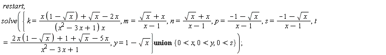

restart; solve(`union`({k = (x*(1-sqrt(x))+sqrt(x)-2*x)/((x^2-3*x+1)*x), m = (sqrt(x)+x)/(x-1), n = (sqrt(x)+x)/(x-1), p = (-1-sqrt(x))/(x-1), s = (-1-sqrt(x))/(x-1), t = (2*x*(1-sqrt(x))+1+sqrt(x)-5*x)/(x^2-3*x+1), y = 1-sqrt(x)}, {0 < s, 0 < x, 0 < y}))
Error, (in unknown) invalid input: SolveTools:-Inequality expects its 1st argument, eqns, to be of type {list, set}({`<`, `<=`, `=`}), but received [-p < 0, And(2*argument((p-1)/p) <= Pi,-Pi < 2*argument((p-1)/p))]
So my question is why does this error occur? And what does it mean? the "but received..." argument in the error makes no sense to me. Why does it happen when I add 0<s but 0<x,0<y is okay?
