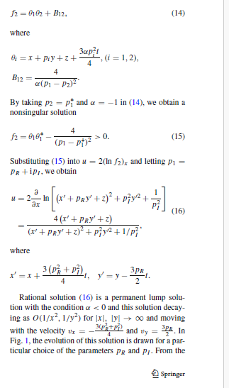

Question: How apply conjugate for getting result of pdetest ?
i did pdetest without conjugate like the paper did i get zero but when i did pde test  with conjugate i didn't where is my problem
i will do without conjugate but how change p[2]=conjugate(p[1])
