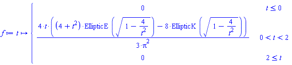

I have a function f(t) which I would like to convolve with itself.  I have no problem doing that typically, but my function contains two elliptic integrals (EllipticE and EllipticK), which clearly complicates matters.

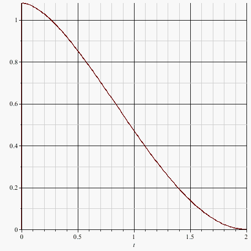

My work in included.  As you can see, the plot on the (0,2) interval is continuous, and the area under the curve sums to unity via numerical integration.

f := proc (t) options operator, arrow; piecewise(t <= 0, 0, 0 < t and t < 2, (4/3)*t*((4+t^2)*EllipticE(sqrt(1-4/t^2))-8*EllipticK(sqrt(1-4/t^2)))/Pi^2, 2 <= t, 0) end proc
plot(f(t), t = 0 .. 2)
evalf(int(f(t), t = 0 .. 2))
1.000000000+0.*I
