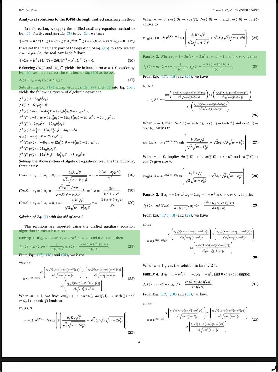

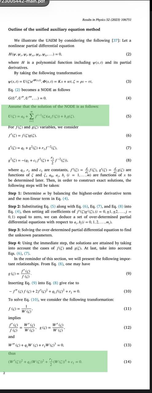

In here i did try my best and my equation outcome are ok but is not same as author did i dont know why, beside this he try to use two ode for constructing  a new ode which find of one solution of this can be the third solution of ode!
 i have to use eq(5) for my orginal ode  but eq(5) contain f(x) and g(x) which by some assumption  and taking two other ode eq(6) and eq(7)  they construct new one which is eq(14) and by f(xi) and g(xi) have corelation with W(xi) which is third ode  as in eq(9) and eq(11) mentioned, i try to use the solution which author mentioned but is not give me solution of third ode by using corelation what is problem here? also in eq(21)  and eq(25) when thus parameter are satisfy must our odetest be zero
