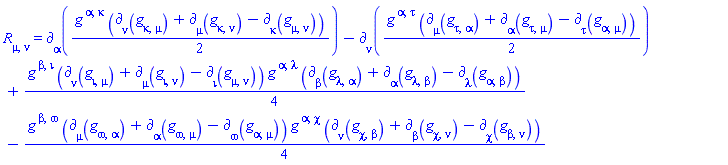

The linearized form of the Ricci tensor is computed by introducing this weakly perturbed metric in the expression of the Ricci  tensor as a function of the metric. This can be accomplished in different ways, the simpler being to use the conversion network between tensors, but for illustration purposes, showing steps one at time, a substitution of definitions one into the other one is used
Ricci[definition];
Physics:-Ricci[mu, nu] = Physics:-d_[alpha](Physics:-Christoffel[`~alpha`, mu, nu], [X])-Physics:-d_[nu](Physics:-Christoffel[`~alpha`, mu, alpha], [X])+Physics:-Christoffel[`~beta`, mu, nu]*Physics:-Christoffel[`~alpha`, beta, alpha]-Physics:-Christoffel[`~beta`, mu, alpha]*Physics:-Christoffel[`~alpha`, nu, beta]
Christoffel[~alpha, mu, nu, definition];
Physics:-Christoffel[`~alpha`, mu, nu] = (1/2)*Physics:-g_[`~alpha`, `~beta`]*(Physics:-d_[nu](Physics:-g_[beta, mu], [X])+Physics:-d_[mu](Physics:-g_[beta, nu], [X])-Physics:-d_[beta](Physics:-g_[mu, nu], [X]))
Substitute((10), (9));
Physics:-Ricci[mu, nu] = Physics:-d_[alpha]((1/2)*Physics:-g_[`~alpha`, `~kappa`]*(Physics:-d_[nu](Physics:-g_[kappa, mu], [X])+Physics:-d_[mu](Physics:-g_[kappa, nu], [X])-Physics:-d_[kappa](Physics:-g_[mu, nu], [X])), [X])-Physics:-d_[nu]((1/2)*Physics:-g_[`~alpha`, `~tau`]*(Physics:-d_[mu](Physics:-g_[tau, alpha], [X])+Physics:-d_[alpha](Physics:-g_[tau, mu], [X])-Physics:-d_[tau](Physics:-g_[alpha, mu], [X])), [X])+(1/4)*Physics:-g_[`~beta`, `~iota`]*(Physics:-d_[nu](Physics:-g_[iota, mu], [X])+Physics:-d_[mu](Physics:-g_[iota, nu], [X])-Physics:-d_[iota](Physics:-g_[mu, nu], [X]))*Physics:-g_[`~alpha`, `~lambda`]*(Physics:-d_[beta](Physics:-g_[lambda, alpha], [X])+Physics:-d_[alpha](Physics:-g_[lambda, beta], [X])-Physics:-d_[lambda](Physics:-g_[alpha, beta], [X]))-(1/4)*Physics:-g_[`~beta`, `~omega`]*(Physics:-d_[mu](Physics:-g_[omega, alpha], [X])+Physics:-d_[alpha](Physics:-g_[omega, mu], [X])-Physics:-d_[omega](Physics:-g_[alpha, mu], [X]))*Physics:-g_[`~alpha`, `~chi`]*(Physics:-d_[nu](Physics:-g_[chi, beta], [X])+Physics:-d_[beta](Physics:-g_[chi, nu], [X])-Physics:-d_[chi](Physics:-g_[beta, nu], [X]))

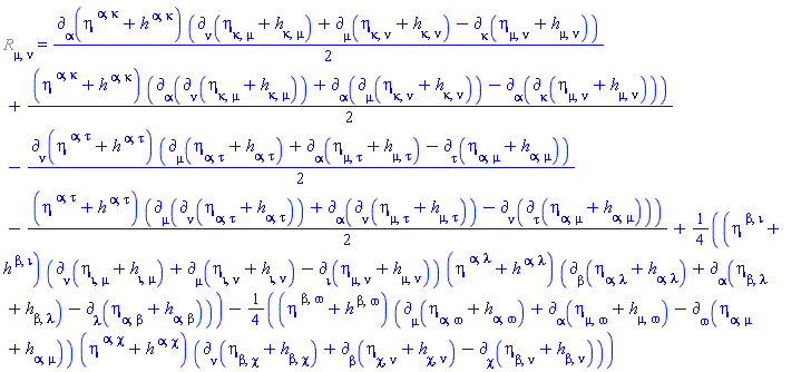

Introducing the perturbed metric, and the inert form of Ricci for simplification purposes
Substitute((7), Ricci = %Ricci, (11));
%Ricci[mu, nu] = (1/2)*Physics:-d_[alpha](eta[`~alpha`, `~kappa`]+h[`~alpha`, `~kappa`], [X])*(Physics:-d_[nu](eta[kappa, mu]+h[kappa, mu], [X])+Physics:-d_[mu](eta[kappa, nu]+h[kappa, nu], [X])-Physics:-d_[kappa](eta[mu, nu]+h[mu, nu], [X]))+(1/2)*(eta[`~alpha`, `~kappa`]+h[`~alpha`, `~kappa`])*(Physics:-d_[alpha](Physics:-d_[nu](eta[kappa, mu]+h[kappa, mu], [X]), [X])+Physics:-d_[alpha](Physics:-d_[mu](eta[kappa, nu]+h[kappa, nu], [X]), [X])-Physics:-d_[alpha](Physics:-d_[kappa](eta[mu, nu]+h[mu, nu], [X]), [X]))-(1/2)*Physics:-d_[nu](eta[`~alpha`, `~tau`]+h[`~alpha`, `~tau`], [X])*(Physics:-d_[mu](eta[alpha, tau]+h[alpha, tau], [X])+Physics:-d_[alpha](eta[mu, tau]+h[mu, tau], [X])-Physics:-d_[tau](eta[alpha, mu]+h[alpha, mu], [X]))-(1/2)*(eta[`~alpha`, `~tau`]+h[`~alpha`, `~tau`])*(Physics:-d_[mu](Physics:-d_[nu](eta[alpha, tau]+h[alpha, tau], [X]), [X])+Physics:-d_[alpha](Physics:-d_[nu](eta[mu, tau]+h[mu, tau], [X]), [X])-Physics:-d_[nu](Physics:-d_[tau](eta[alpha, mu]+h[alpha, mu], [X]), [X]))+(1/4)*(eta[`~beta`, `~iota`]+h[`~beta`, `~iota`])*(Physics:-d_[nu](eta[iota, mu]+h[iota, mu], [X])+Physics:-d_[mu](eta[iota, nu]+h[iota, nu], [X])-Physics:-d_[iota](eta[mu, nu]+h[mu, nu], [X]))*(eta[`~alpha`, `~lambda`]+h[`~alpha`, `~lambda`])*(Physics:-d_[beta](eta[alpha, lambda]+h[alpha, lambda], [X])+Physics:-d_[alpha](eta[beta, lambda]+h[beta, lambda], [X])-Physics:-d_[lambda](eta[alpha, beta]+h[alpha, beta], [X]))-(1/4)*(eta[`~beta`, `~omega`]+h[`~beta`, `~omega`])*(Physics:-d_[mu](eta[alpha, omega]+h[alpha, omega], [X])+Physics:-d_[alpha](eta[mu, omega]+h[mu, omega], [X])-Physics:-d_[omega](eta[alpha, mu]+h[alpha, mu], [X]))*(eta[`~alpha`, `~chi`]+h[`~alpha`, `~chi`])*(Physics:-d_[nu](eta[beta, chi]+h[beta, chi], [X])+Physics:-d_[beta](eta[chi, nu]+h[chi, nu], [X])-Physics:-d_[chi](eta[beta, nu]+h[beta, nu], [X]))
The sign infront of the perturbation in the inverse metric is wrong, it should be minus.
This expression contains several terms quadratic in the small perturbation h[mu, nu]. The routine to filter out those terms is Linearize, that takes as second argument the symbol representing the small quantities (perturbation)
