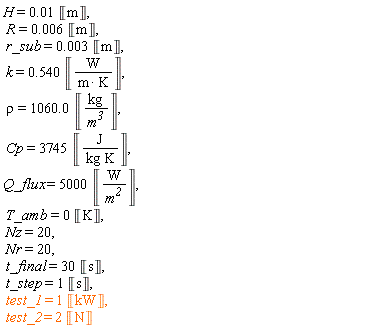

For a numericial integration I want to check if all physical parameters are given in SI base units (before stripping of the units for the integration). Right now I am doing this
Parameters
H = 0.1e-1*Unit('m'), R = 0.6e-2*Unit('m'), r_sub = 0.3e-2*Unit('m'), k = .540*Unit('W'/('m'*'K')), rho = 1060.0*Unit('kg'/'m'^3), Cp = 3745*Unit('J'/('kg'*'K')), Q_flux = 5000*Unit('W'/'m'^2), T_amb = 0*Unit('K'), Nz = 20, Nr = 20, t_final = 30*Unit('s'), t_step = Unit('s'), test_1 = Unit('kW'), test_2 = 2*Unit('N')
H = 0.1e-1*Units:-Unit(m), R = 0.6e-2*Units:-Unit(m), r_sub = 0.3e-2*Units:-Unit(m), k = .540*Units:-Unit(W/(m*K)), rho = 1060.0*Units:-Unit(kg/m^3), Cp = 3745*Units:-Unit(J/(kg*K)), Q_flux = 5000*Units:-Unit(W/m^2), T_amb = 0, Nz = 20, Nr = 20, t_final = 30*Units:-Unit(s), t_step = Units:-Unit(s), test_1 = Units:-Unit(kW), test_2 = 2*Units:-Unit(N)

test_1: unit given in kilos
test_2: unit given in derived base units
