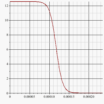

plot(n/n0, 0 .. 2*R);

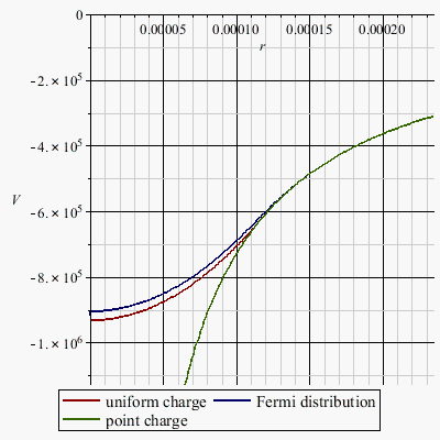

plot([Vuniform(r), Vfermi(r), -Z/r], r = r0 .. 2*R, V = 1.2*Vfermi(r0) .. 0, legend = ["uniform charge", "Fermi distribution", "point charge"]);

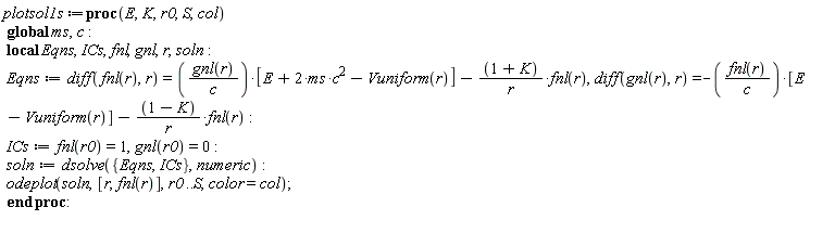

plotsol1s := proc (E, K, r0, S, col) local Eqns, ICs, fnl, gnl, r, soln; global ms, c; Eqns := diff(fnl(r), r) = gnl(r)*[E+2*ms*c^2-Vuniform(r)]/c-(K+1)*fnl(r)/r, diff(gnl(r), r) = -fnl(r)*[E-Vuniform(r)]/c-(1-K)*fnl(r)/r; ICs := fnl(r0) = 1, gnl(r0) = 0; soln := dsolve({Eqns, ICs}, numeric); plots:-odeplot(soln, [r, fnl(r)], r0 .. S, color = col) end proc:
plotsol1s(-3*10^5, -1, 10^(-10), Rm, red)
Error, (in f) unable to store '[HFloat(0.0)]' when datatype=float[8]
