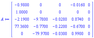

A:=Matrix(5,[[-0.9800,0,0,-0.0160,0],[1.0000,0,0,0,0],[-2.1900,-9.7800,-0.0280,0.0740,0],[77.3600,-0.7700,-0.2200,-0.6700,0],[0,-79.9700,-0.0300,0.9900,0]]);
A := Matrix(5, 5, {(1, 1) = -.9800, (1, 2) = 0, (1, 3) = 0, (1, 4) = -0.160e-1, (1, 5) = 0, (2, 1) = 1.0000, (2, 2) = 0, (2, 3) = 0, (2, 4) = 0, (2, 5) = 0, (3, 1) = -2.1900, (3, 2) = -9.7800, (3, 3) = -0.280e-1, (3, 4) = 0.740e-1, (3, 5) = 0, (4, 1) = 77.3600, (4, 2) = -.7700, (4, 3) = -.2200, (4, 4) = -.6700, (4, 5) = 0, (5, 1) = 0, (5, 2) = -79.9700, (5, 3) = -0.300e-1, (5, 4) = .9900, (5, 5) = 0})

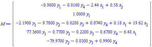

M:=A.b+B.X
M := Matrix(5, 1, {(1, 1) = -.9800*y[1]-0.160e-1*y[4]-2.44*x[1]+.58*x[2], (2, 1) = 1.0000*y[1], (3, 1) = -2.1900*y[1]-9.7800*y[2]-0.280e-1*y[3]+0.740e-1*y[4]+.18*x[1]+19.62*x[2], (4, 1) = 77.3600*y[1]-.7700*y[2]-.2200*y[3]-.6700*y[4]-6.48*x[1], (5, 1) = -79.9700*y[2]-0.300e-1*y[3]+.9900*y[4]})

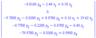

eval(M,y[1]=0)
Matrix([[-0.160e-1*y[4]-2.44*x[1]+.58*x[2]], [0.], [-9.7800*y[2]-0.280e-1*y[3]+0.740e-1*y[4]+.18*x[1]+19.62*x[2]], [-.7700*y[2]-.2200*y[3]-.6700*y[4]-6.48*x[1]], [-79.9700*y[2]-0.300e-1*y[3]+.9900*y[4]]])
Download solve.mw
actually the problem to be solved is M=0 ! which directly goes to y[1]=0;
after that , how can i find other unknowns so that M=0 is ok. tnx
