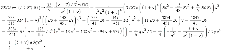

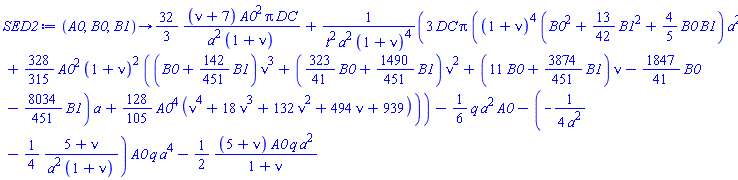

SED2 := proc (A0, B0, B1) options operator, arrow; (32/3)*(nu+7)*A0^2*Pi*DC/(a^2*(1+nu))+3*DC*Pi*((1+nu)^4*(B0^2+(13/42)*B1^2+(4/5)*B0*B1)*a^2+(328/315)*A0^2*(1+nu)^2*((B0+(142/451)*B1)*nu^3+((323/41)*B0+(1490/451)*B1)*nu^2+(11*B0+(3874/451)*B1)*nu-(1847/41)*B0-(8034/451)*B1)*a+(128/105)*A0^4*(nu^4+18*nu^3+132*nu^2+494*nu+939))/(t^2*a^2*(1+nu)^4)-(1/6)*q*a^2*A0-(-(1/4)/a^2-(1/4)*(5+nu)/(a^2*(1+nu)))*A0*q*a^4-(1/2)*(5+nu)*A0*q*a^2/(1+nu) end proc;
