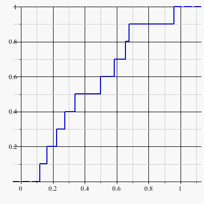

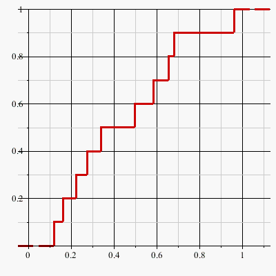

Here is an illustrative example where I would prefer to write
ecdf(S, color="red", thickness=3)
instead of
ecdf(S, ecdf_color="red", ecdf_thickness=3)
ecdf := proc(S, {ecdf_color::string:="blue", ecdf_thickness::posint:=1})
  local N   := numelems(S):
  local M   := sort(S):
  local opt := [color=ecdf_color, thickness=ecdf_thickness]:
  plots:-display(
    plot([ seq(op([[M[i], (i-1)/N], [M[i], i/N], [M[i+1], i/N]]), i=1..N-1) ], opt[])
    , plot([ [M[N], (N-1)/N], [M[N], 1] ], opt[])
    , plot([ [M[N], 1], [(max+(max-min)*0.2)(S), 1] ], opt[], linestyle=3)
    , plot([ [M[1], 0], [(min-(max-min)*0.2)(S), 0] ], opt[], linestyle=3)
S := Statistics:-Sample(Uniform(0, 1), 10):
ecdf(S)
