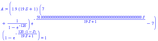

variphi:=0.38:R1:=0.0009:R2:=8.75:E1:=1:E2:=1:R4:=177.6:C:=1.96:k:=4:H:=7:Pec_i:=-120:Phi:=1:Q:=1.9:R:=20:
A:=(Q*(R*S+1-S)*(H+1/(1-exp(Pec_i)))*exp(C*Pec_i*S/(k*(R*S+1-S)))-H)*(1-exp(Pec_i*(1-S)/(R*S+1-S)))=1;
eqn2:=Student:-Calculus1:-Roots(subs(H=7,R=20,C=1.96,k=4,Pec_i=-120,Q=1.9,A),S);

In the above data list we can see that due to numerical noise there is a big jump. I am trying to find the solution in the interval [1, 10]. But due to multiple solutions I am unable to control noise. I have also tried to adjust the range (sigma=-350..5 ).
