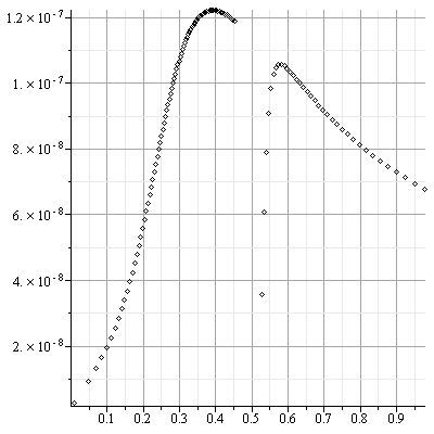

First,I used the command CurveFitting[ThieleInterpolation] to get two functions.
And then pointplot the (y0-y1)/y0 at the same x0 coordinate.
Surprisingly,the plot is discontinued.
Between the x coordinate 0.45 and 0.6,it seems that there is a discontinuous point.
I think the problem is that the difference between y0 and y1 is very small,so the Digits was redefined for 30.
But the problem is still exist.
Help,thank you in advance.
