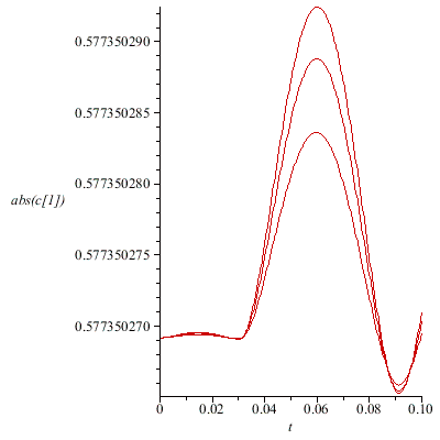

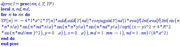

dproc3 := proc (nn, t, Y, YP) local n, nd, md;  for n to nn do; YP[n] := -((I*e^2*4)/(h*a^2))*Y[n]*add(add(Y[nd]*conjugate(Y[nd])*evalf(Int(evalf(Int(sin(Pi*n*x/a)*sin(Pi*nd*x/a)*sin(Pi*n*y/a)*sin(Pi*nd*y/a)/sqrt((x-y)^2+4*R^2*sin(Pi*md/mm)^2), y = 0. .. a)), x = 0. .. a)), md = 1 .. mm-1),   nd = 1 .. nn); end do;end proc; ic3 := array([seq(1/sqrt(nn), n = 1 .. nn)]); dvars3 := [seq(c[n](t), n = 1 .. nn)]; p := dsolve(type=numeric, number = nn, procedure = dproc3, start = 0., initial = ic3, procvars = dvars3, range=0..0.1, method=rkf45); FormatTime(%c);display([seq(odeplot(p,[t,abs(c[n](t))]),n=1 .. nn)]);
dproc3 := proc (nn, t, Y, YP) local n, nd, md; for n to nn do YP[n] := -(4*I)*e^2*Y[n]*add(add(Y[nd]*conjugate(Y[nd])*evalf(Int(evalf(Int(sin(Pi*n*x/a)*sin(Pi*nd*x/a)*sin(Pi*n*y/a)*sin(Pi*nd*y/a)/sqrt((x-y)^2+4*R^2*sin(Pi*md/mm)^2), y = 0. .. a)), x = 0. .. a)), md = 1 .. mm-1), nd = 1 .. nn)/(h*a^2) end do end proc
