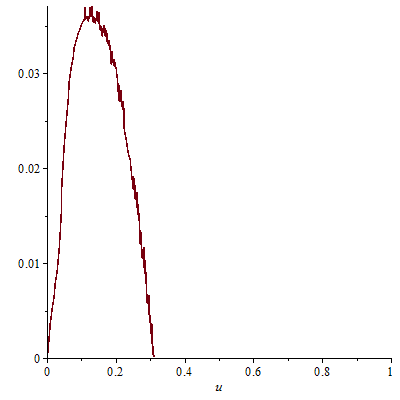

However, a quick plot shows that there is a maximum (obviously) and that the curve is not flat but quite strongly curved, suggesting to me that it should be easier for Maximize to find the max.
Once I know where the maximum is located, I can change the range of values to search over and finally find the maximum:
Optimization:-Maximize(eval(xsol,E=1),u=0.1..0.3,'variables'=[u],assume=nonnegative);

plot( eval(xsol,E=1),u=0..1);
