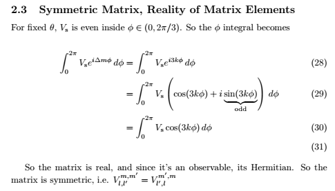

     I'm computing some difficult integrals, involving Spherical Harmonics. I've proved that the answer must be a real number, and yet Maple returns a complex number. Also Mathematica returns purely real numbers, so I wonder if there is a bug in Maple. I found if I break the integrand into real and imaginary parts, and add them I get the right answer...usually.  Anyway's here's the code and the proof, I suspect they could be a bug somewhere, since there was a bug in plotting SphericalY's found earlier ... Unfortunatly the previous trick, Y:=(l,m,theta, phi)->simplify(convert( SphericalY(l,m,theta, phi),elementary)): does not fix this issue....

and the proof...
