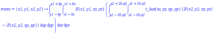

I want to calculate the following function for different points (x1,y1) , (x2,y2):
trans := (x1, y1, x2, y2) -> int(int(B(x1, y1, xz, yz)*(int(int(t_hat(xz, yz, xp, yp)*(B(x2, y2, xz, yz)-B(x2, y2, xp, yp)), xp = x2-10*sigma1 .. x2+10*sigma1), yp = y2-10*sigma2 .. y2+10*sigma2)), xz = x1-hx .. x1+hx), yz = y1-hy .. y1+hy);
this integral in the form that is in the work sheet, works well for phi=0 and the results are what I want (numbers that go to zero as we move points 1 and 2 away from each other). for other values for phi it either gives an error (too many levels of recursion) or it returns expressions that seem unreasonable when I evaluate them (they don't go to zero).
for example, it doesn't work for phi = 0.5 at all. for phi = Pi/4 it will calculate some expression,
but as you move away from a point (e.g. trans(0,0,100,100)) the value does not become smaller than a certain value, but they should go to zero.
It seems that what I am trying to do is very sensitive to a,b,c, but actually it shouldn't be so different. I like to avoid exact integration, and just get a number, but I have no idea how to do this numerically. and I don't know how to write the problem in a way that would work for every angle phi.

trans := proc (x1, y1, x2, y2) options operator, arrow; int(int(B(x1, y1, xz, yz)*(int(int(t_hat(xz, yz, xp, yp)*(B(x2, y2, xz, yz)-B(x2, y2, xp, yp)), xp = x2-10*sigma1 .. x2+10*sigma1), yp = y2-10*sigma2 .. y2+10*sigma2)), xz = x1-hx .. x1+hx), yz = y1-hy .. y1+hy) end proc
