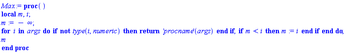

I'm having some trouble trying to make it so the answer Max(3,1,x,4) turns into Max(x,4), that is, only the greates number and the non numerical values are returned. I've tried a bunch of different things, but have gone out of ideas.
This is the link to the Maple file :6-1.mw and this is the code:
#Improve the general Max procedure on page 224 so that Max(3,x,1,4)returns Max(x,4). That is, the procedure returns the maximum numerical value along with all nonnumerical values.
Max:=proc() local m, i;
m:=-infinity;
for i in (args) do
  if not type(i, numeric) then
    return 'procname'(args):
  end if;
  if i>m then
    m:=i
  end if;
end do;
m;
end proc;
proc () local m, i; m := -infinity; for i in args do if not type(i, numeric) then return ('procname')(args) end if; if m < i then m := i end if end do; m end proc
Max(3,1,x,4);
Max(3, 1, x, 4)
Would really appreaciate your help with this
