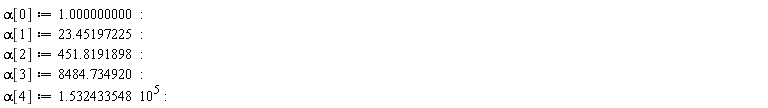

restart; with(plots); with(Statistics)
alpha[0] := 1.000000000:
m__max := 4:
model := Fit(pochhammer(z__1, m)*h__exp^m/factorial(m), [seq(m, m = 0 .. m__max)], [seq(alpha[m], m = 0 .. m__max)], m, output = [leastsquaresfunction, residuals], weights = [seq(1/abs(alpha[m]), m = 0 .. m__max)], iterationlimit = 10000)

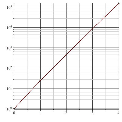

model := [pochhammer(1.42349754368085, m)*16.2763580438677^m/factorial(m), Vector[row](5, {(1) = 0., (2) = -0.120508651249829e-1, (3) = 0.113910530162494e-1, (4) = 0.348907003220054e-3, (5) = -0.305508272150429e-2})]
plots[multiple](logplot, [{seq([m, alpha[m]], m = 0 .. m__max)}, style = point, color = black], [{seq([m, model[1]], m = 0 .. m__max)}])
