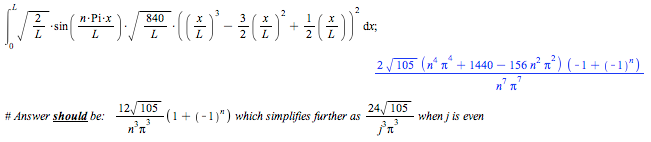

I'm going back over QM homeworks to study for an exam. We're allowed to use Maple on our exam so I want to be sure I'm prepared for that part. I have the solution to a problem I'm working on, but I can't get Maple to simplify it how I want it.
Is that simplification something that Maple should be able to do or is it something I would need to know how to do because Maple isn't capable? (I assume it is.)
