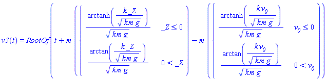

deq3 := m*(diff(v3(t), t)) = -m*g-k*v3(t)*abs(v3(t))
sol3 := dsolve({deq3, v3(0) = v__0}, v3(t))
v3(t) = RootOf(t+m*piecewise(_Z <= 0, arctanh(k*_Z/(k*m*g)^(1/2))/(k*m*g)^(1/2), 0 < _Z, arctan(k*_Z/(k*m*g)^(1/2))/(k*m*g)^(1/2))-m*piecewise(v__0 <= 0, arctanh(k*v__0/(k*m*g)^(1/2))/(k*m*g)^(1/2), 0 < v__0, arctan(k*v__0/(k*m*g)^(1/2))/(k*m*g)^(1/2)))
V3 := unapply(rhs(sol3), t):
m := 0.258e-2:
plot([V(t), V2(t), V3(t)], t = 0 .. 5, color = [blue, red, black], gridlines = true)
