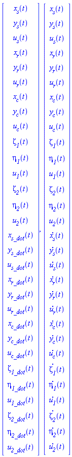

Vector[column](DOTL),Vector[column](DOTR);

Vector(30, {(1) = x__s(t), (2) = y__s(t), (3) = u__s(t), (4) = x__r(t), (5) = y__r(t), (6) = u__r(t), (7) = x__c(t), (8) = y__c(t), (9) = u__c(t), (10) = `ζ__1`(t), (11) = `η__1`(t), (12) = u__1(t), (13) = `ζ__2`(t), (14) = `η__2`(t), (15) = u__2(t), (16) = x__s_dot(t), (17) = y__s_dot(t), (18) = u__s_dot(t), (19) = x__r_dot(t), (20) = y__r_dot(t), (21) = u__r_dot(t), (22) = x__c_dot(t), (23) = y__c_dot(t), (24) = u__c_dot(t), (25) = `ζ__1_dot`(t), (26) = `η__1_dot`(t), (27) = u__1_dot(t), (28) = `ζ__2_dot`(t), (29) = `η__2_dot`(t), (30) = u__2_dot(t)}), Vector(30, {(1) = x__s(t), (2) = y__s(t), (3) = u__s(t), (4) = x__r(t), (5) = y__r(t), (6) = u__r(t), (7) = x__c(t), (8) = y__c(t), (9) = u__c(t), (10) = `ζ__1`(t), (11) = `η__1`(t), (12) = u__1(t), (13) = `ζ__2`(t), (14) = `η__2`(t), (15) = u__2(t), (16) = diff(x__s(t), t), (17) = diff(y__s(t), t), (18) = diff(u__s(t), t), (19) = diff(x__r(t), t), (20) = diff(y__r(t), t), (21) = diff(u__r(t), t), (22) = diff(x__c(t), t), (23) = diff(y__c(t), t), (24) = diff(u__c(t), t), (25) = diff(`ζ__1`(t), t), (26) = diff(`η__1`(t), t), (27) = diff(u__1(t), t), (28) = diff(`ζ__2`(t), t), (29) = diff(`η__2`(t), t), (30) = diff(u__2(t), t)})
Vector[column](newxx);
Vector(30, {(1) = x__s(t), (2) = y__s(t), (3) = u__s(t), (4) = x__r(t), (5) = y__r(t), (6) = u__r(t), (7) = x__c(t), (8) = y__c(t), (9) = u__c(t), (10) = `ζ__1`(t), (11) = `η__1`(t), (12) = u__1(t), (13) = `ζ__2`(t), (14) = `η__2`(t), (15) = u__2(t), (16) = x__s_dot(t), (17) = y__s_dot(t), (18) = u__s_dot(t), (19) = x__r_dot(t), (20) = y__r_dot(t), (21) = u__r_dot(t), (22) = x__c_dot(t), (23) = y__c_dot(t), (24) = u__c_dot(t), (25) = `ζ__1_dot`(t), (26) = `η__1_dot`(t), (27) = u__1_dot(t), (28) = `ζ__2_dot`(t), (29) = `η__2_dot`(t), (30) = diff(u__2(t), t)})

I tried to make a for loop that substitutes each variable one by one, but it only seems to work for the last term, I don't know why, please help or suggest another method? I also have diff(x__s,t,t) terms in my equations, not just diff(x__s,t), but I guess only by specifying the first derivate it should work?
