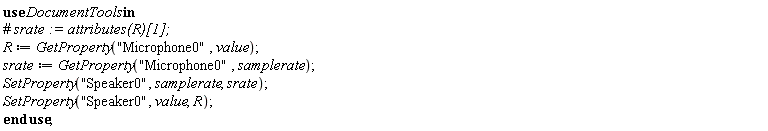

Can any one help me correct my doc wherein I want to record 5 minutes with microphone and play it for the same duration through my speaker with a click of button component. I find problem in file path specification.This document in my PC is  in E:\A_PhD2017\MAPLEPhDFiles\RequestCorrection_Microphone_Speaker_from_primetime.mw
Components added are only three: microphone0, Speaker0 and Button0
Edit*Data*Available*Action*contains*the*following*commands
rate := DocumentTools:-GetProperty("Microphone0", samplerate); 1; R := DocumentTools:-GetProperty("Microphone0", value)
Array(%id = 18446745571883247742)
Edit Click Action for Button contains the following commands.
R := DocumentTools:-GetProperty("Microphone0", value); 1; srate := DocumentTools:-GetProperty("Microphone0", samplerate); 1; DocumentTools:-SetProperty("Speaker0", samplerate, srate); 1; DocumentTools:-SetProperty("Speaker0", value, R)
16000
No errors displayed for both the above doc tools use``
Also nonstop continuous evaluation takes place! Where is the loop formation if at all there is any?
