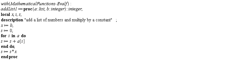

Dear colleagues, Can anyone explain what (a::list,b::list) will be understood by the programme?
I thought the programme is made for only adding the numbers in the list. But it seems there is something more than that, i could not get.
Equn label (6) onwards, I donot understand, how the answer was obtained.
Thanks for explaining.

with(MathematicalFunctions:-Evalf); -1; addList1 := proc (a::list, b::integer)::integer; local x, i, s; description "add a list of numbers and multiply by a constant"; x := b; s := 0; for i in a do s := s+a[i] end do; s := s*x end proc
