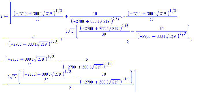

s:=[solve(f)]; evalf(%);  # All the roots are real
[(1/30)*(-2700+(300*I)*219^(1/2))^(1/3)+10/(-2700+(300*I)*219^(1/2))^(1/3), -(1/60)*(-2700+(300*I)*219^(1/2))^(1/3)-5/(-2700+(300*I)*219^(1/2))^(1/3)+((1/2)*I)*3^(1/2)*((1/30)*(-2700+(300*I)*219^(1/2))^(1/3)-10/(-2700+(300*I)*219^(1/2))^(1/3)), -(1/60)*(-2700+(300*I)*219^(1/2))^(1/3)-5/(-2700+(300*I)*219^(1/2))^(1/3)-((1/2)*I)*3^(1/2)*((1/30)*(-2700+(300*I)*219^(1/2))^(1/3)-10/(-2700+(300*I)*219^(1/2))^(1/3))]
[.8788850663-0.2e-9*I, -1.088033915-0.2598076212e-9*I, .2091488484+0.2598076212e-9*I]
max(s);  # ?
Error, (in simpl/max) complex argument to max/min: (1/30)*(-2700+(300*I)*219^(1/2))^(1/3)+10/(-2700+(300*I)*219^(1/2))^(1/3)
type(s,list(realcons)); # Wrong, the type realcons should not be purely syntactic; or is it?
