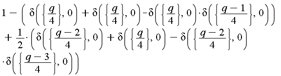

1-(delta({(1/4)*q}, 0)+delta({(1/4)*q}, 0))+delta({(1/4)*q}, 0)*delta({(q-1)*(1/4)}, 0)+1/2*(delta({(q-2)*(1/4)}, 0)+delta({(1/4)*q}, 0)-delta({(q-2)*(1/4)}, 0)*delta({(q-3)*(1/4)}, 0))

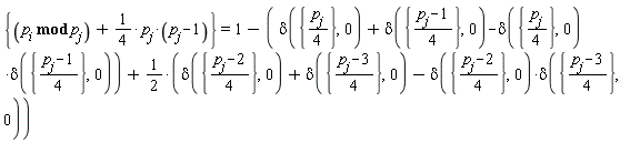

{`mod`(p[i], p[j])+(1/4)*p[j]*(p[j]-1)} = 1-delta({(1/4)*p[j]}, 0)-delta({(p[j]-1)*(1/4)}, 0)+delta({(1/4)*p[j]}, 0)*delta({(p[j]-1)*(1/4)}, 0)+1/2*(delta({(p[j]-2)*(1/4)}, 0)+delta({(p[j]-3)*(1/4)}, 0)-delta({(p[j]-2)*(1/4)}, 0)*delta({(p[j]-3)*(1/4)}, 0))

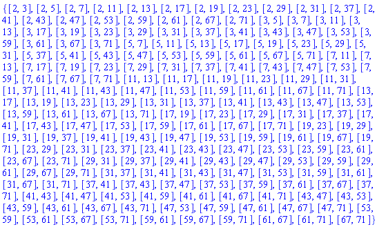

QueryIdentity(20); T; F
{[2, 3], [2, 5], [2, 7], [2, 11], [2, 13], [2, 17], [2, 19], [2, 23], [2, 29], [2, 31], [2, 37], [2, 41], [2, 43], [2, 47], [2, 53], [2, 59], [2, 61], [2, 67], [2, 71], [3, 5], [3, 7], [3, 11], [3, 13], [3, 17], [3, 19], [3, 23], [3, 29], [3, 31], [3, 37], [3, 41], [3, 43], [3, 47], [3, 53], [3, 59], [3, 61], [3, 67], [3, 71], [5, 7], [5, 11], [5, 13], [5, 17], [5, 19], [5, 23], [5, 29], [5, 31], [5, 37], [5, 41], [5, 43], [5, 47], [5, 53], [5, 59], [5, 61], [5, 67], [5, 71], [7, 11], [7, 13], [7, 17], [7, 19], [7, 23], [7, 29], [7, 31], [7, 37], [7, 41], [7, 43], [7, 47], [7, 53], [7, 59], [7, 61], [7, 67], [7, 71], [11, 13], [11, 17], [11, 19], [11, 23], [11, 29], [11, 31], [11, 37], [11, 41], [11, 43], [11, 47], [11, 53], [11, 59], [11, 61], [11, 67], [11, 71], [13, 17], [13, 19], [13, 23], [13, 29], [13, 31], [13, 37], [13, 41], [13, 43], [13, 47], [13, 53], [13, 59], [13, 61], [13, 67], [13, 71], [17, 19], [17, 23], [17, 29], [17, 31], [17, 37], [17, 41], [17, 43], [17, 47], [17, 53], [17, 59], [17, 61], [17, 67], [17, 71], [19, 23], [19, 29], [19, 31], [19, 37], [19, 41], [19, 43], [19, 47], [19, 53], [19, 59], [19, 61], [19, 67], [19, 71], [23, 29], [23, 31], [23, 37], [23, 41], [23, 43], [23, 47], [23, 53], [23, 59], [23, 61], [23, 67], [23, 71], [29, 31], [29, 37], [29, 41], [29, 43], [29, 47], [29, 53], [29, 59], [29, 61], [29, 67], [29, 71], [31, 37], [31, 41], [31, 43], [31, 47], [31, 53], [31, 59], [31, 61], [31, 67], [31, 71], [37, 41], [37, 43], [37, 47], [37, 53], [37, 59], [37, 61], [37, 67], [37, 71], [41, 43], [41, 47], [41, 53], [41, 59], [41, 61], [41, 67], [41, 71], [43, 47], [43, 53], [43, 59], [43, 61], [43, 67], [43, 71], [47, 53], [47, 59], [47, 61], [47, 67], [47, 71], [53, 59], [53, 61], [53, 67], [53, 71], [59, 61], [59, 67], [59, 71], [61, 67], [61, 71], [67, 71]}

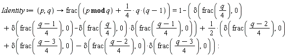

Identity := proc (p, q) options operator, arrow; frac(`mod`(p, q)+(1/4)*q*(q-1)) = 1-delta(frac((1/4)*q), 0)-delta(frac((1/4)*q-1/4), 0)+delta(frac((1/4)*q), 0)*delta(frac((1/4)*q-1/4), 0)+(1/2)*delta(frac((1/4)*q-1/2), 0)+(1/2)*delta(frac((1/4)*q-3/4), 0)-(1/2)*delta(frac((1/4)*q-1/2), 0)*delta(frac((1/4)*q-3/4), 0) end proc:

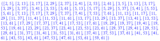

QueryIdentity(20):
{[2, 5], [2, 13], [2, 17], [2, 29], [2, 37], [2, 41], [2, 53], [2, 61], [3, 5], [3, 13], [3, 17], [3, 29], [3, 37], [3, 41], [3, 53], [3, 61], [5, 13], [5, 17], [5, 29], [5, 37], [5, 41], [5, 53], [5, 61], [7, 13], [7, 17], [7, 29], [7, 37], [7, 41], [7, 53], [7, 61], [11, 13], [11, 17], [11, 29], [11, 37], [11, 41], [11, 53], [11, 61], [13, 17], [13, 29], [13, 37], [13, 41], [13, 53], [13, 61], [17, 29], [17, 37], [17, 41], [17, 53], [17, 61], [19, 29], [19, 37], [19, 41], [19, 53], [19, 61], [23, 29], [23, 37], [23, 41], [23, 53], [23, 61], [29, 37], [29, 41], [29, 53], [29, 61], [31, 37], [31, 41], [31, 53], [31, 61], [37, 41], [37, 53], [37, 61], [41, 53], [41, 61], [43, 53], [43, 61], [47, 53], [47, 61], [53, 61], [59, 61]}

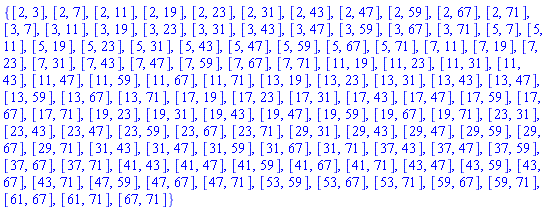

{[2, 3], [2, 7], [2, 11], [2, 19], [2, 23], [2, 31], [2, 43], [2, 47], [2, 59], [2, 67], [2, 71], [3, 7], [3, 11], [3, 19], [3, 23], [3, 31], [3, 43], [3, 47], [3, 59], [3, 67], [3, 71], [5, 7], [5, 11], [5, 19], [5, 23], [5, 31], [5, 43], [5, 47], [5, 59], [5, 67], [5, 71], [7, 11], [7, 19], [7, 23], [7, 31], [7, 43], [7, 47], [7, 59], [7, 67], [7, 71], [11, 19], [11, 23], [11, 31], [11, 43], [11, 47], [11, 59], [11, 67], [11, 71], [13, 19], [13, 23], [13, 31], [13, 43], [13, 47], [13, 59], [13, 67], [13, 71], [17, 19], [17, 23], [17, 31], [17, 43], [17, 47], [17, 59], [17, 67], [17, 71], [19, 23], [19, 31], [19, 43], [19, 47], [19, 59], [19, 67], [19, 71], [23, 31], [23, 43], [23, 47], [23, 59], [23, 67], [23, 71], [29, 31], [29, 43], [29, 47], [29, 59], [29, 67], [29, 71], [31, 43], [31, 47], [31, 59], [31, 67], [31, 71], [37, 43], [37, 47], [37, 59], [37, 67], [37, 71], [41, 43], [41, 47], [41, 59], [41, 67], [41, 71], [43, 47], [43, 59], [43, 67], [43, 71], [47, 59], [47, 67], [47, 71], [53, 59], [53, 67], [53, 71], [59, 67], [59, 71], [61, 67], [61, 71], [67, 71]}
BUT CHECKING THESE RESULTS 'MANUALLY' CONFIRMS THE EQUALITY IS INDEED TRUE FOR ALL ODD PRIME PAIRS  p,q.
{seq(F[k][2], k = 1 .. nops(F))}
{3, 7, 11, 19, 23, 31, 43, 47, 59, 67, 71}

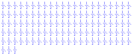

seq(frac(`mod`(F[k][1], F[k][2])+(1/4)*F[k][2]*(F[k][2]-1)), k = 1 .. nops(F))
1/2, 1/2, 1/2, 1/2, 1/2, 1/2, 1/2, 1/2, 1/2, 1/2, 1/2, 1/2, 1/2, 1/2, 1/2, 1/2, 1/2, 1/2, 1/2, 1/2, 1/2, 1/2, 1/2, 1/2, 1/2, 1/2, 1/2, 1/2, 1/2, 1/2, 1/2, 1/2, 1/2, 1/2, 1/2, 1/2, 1/2, 1/2, 1/2, 1/2, 1/2, 1/2, 1/2, 1/2, 1/2, 1/2, 1/2, 1/2, 1/2, 1/2, 1/2, 1/2, 1/2, 1/2, 1/2, 1/2, 1/2, 1/2, 1/2, 1/2, 1/2, 1/2, 1/2, 1/2, 1/2, 1/2, 1/2, 1/2, 1/2, 1/2, 1/2, 1/2, 1/2, 1/2, 1/2, 1/2, 1/2, 1/2, 1/2, 1/2, 1/2, 1/2, 1/2, 1/2, 1/2, 1/2, 1/2, 1/2, 1/2, 1/2, 1/2, 1/2, 1/2, 1/2, 1/2, 1/2, 1/2, 1/2, 1/2, 1/2, 1/2, 1/2, 1/2, 1/2, 1/2, 1/2, 1/2, 1/2, 1/2, 1/2, 1/2, 1/2, 1/2

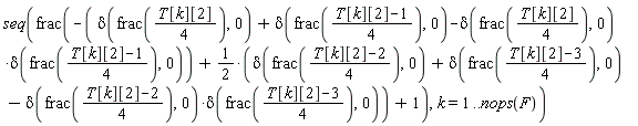

seq(frac(-delta(frac((1/4)*F[k][2]), 0)-delta(frac((F[k][2]-1)*(1/4)), 0)+delta(frac((1/4)*F[k][2]), 0)*delta(frac((F[k][2]-1)*(1/4)), 0)+1/2*(delta(frac((F[k][2]-2)*(1/4)), 0)+delta(frac((F[k][2]-3)*(1/4)), 0)-delta(frac((F[k][2]-2)*(1/4)), 0)*delta(frac((F[k][2]-3)*(1/4)), 0))+1), k = 1 .. nops(F))
