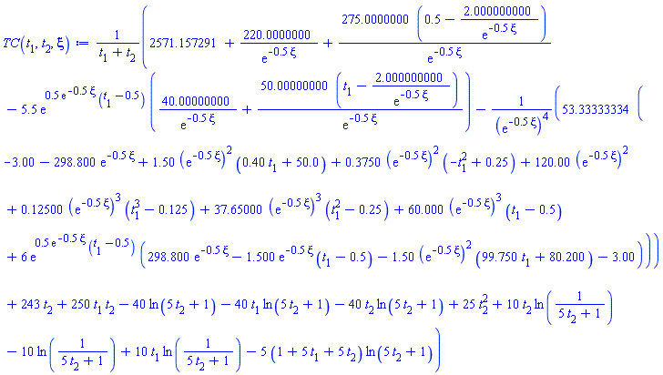

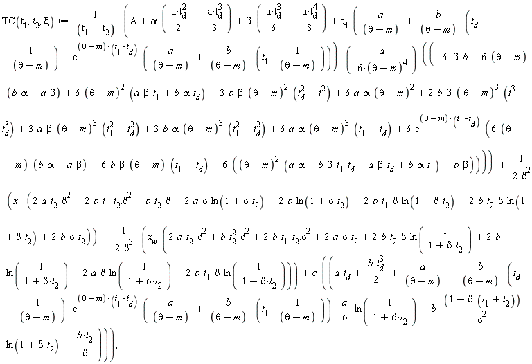

TC(t[1], t[2], xi) := (A+alpha*((1/2)*a*t[d]^2+(1/3)*a*t[d]^3)+beta*((1/6)*a*t[d]^3+(1/8)*a*t[d]^4)+t[d]*(a/(theta-m)+b*(t[d]-1/(theta-m))/(theta-m)-exp((theta-m)*(t[1]-t[d]))*(a/(theta-m)+b*(t[1]-1/(theta-m))/(theta-m)))-a*(-6*beta*b-(6*(theta-m))*(-a*beta+alpha*b)+6*(theta-m)^2*(a*beta*t[1]+alpha*b*t[d])+3*b*beta*(theta-m)^2*(-t[1]^2+t[d]^2)+6*a*alpha*(theta-m)^2+2*b*beta*(theta-m)^3*(t[1]^3-t[d]^3)+3*a*beta*(theta-m)^3*(t[1]^2-t[d]^2)+3*b*alpha*(theta-m)^3*(t[1]^2-t[d]^2)+6*a*alpha*(theta-m)^3*(t[1]-t[d])+6*exp((theta-m)*(t[1]-t[d]))*((6*(theta-m))*(-a*beta+alpha*b)-6*b*beta*(theta-m)*(t[1]-t[d])-6*((theta-m)^2*(-b*beta*t[1]*t[d]+a*beta*t[d]+alpha*b*t[1]+a*alpha)+beta*b)))/(6*(theta-m)^4)+x[1]*(2*a*t[2]*delta^2+2*b*t[1]*t[2].(delta^2)+b*t[2]*delta-2*a*delta*ln(delta*t[2]+1)-2*b*ln(delta*t[2]+1)-2*b*t[1]*delta*ln(delta*t[2]+1)-2*b*t[2]*delta*ln(delta*t[2]+1)+2*b*t[2]*delta)/(2*delta^2)+x[w]*(2*a*t[2]*delta^2+b*t[2]^2*delta^2+2*b*t[1]*t[2].(delta^2)+2*a*delta*t[2]+2*b*t[2]*delta*ln(1/(delta*t[2]+1))+2*b*ln(1/(delta*t[2]+1))+2*a*delta*ln(1/(delta*t[2]+1))+2*b*t[1]*delta*ln(1/(delta*t[2]+1)))/(2*delta^3)+c*(a*t[d]+(1/2)*b*t[d]^3+a/(theta-m)+b*(t[d]-1/(theta-m))/(theta-m)-exp((theta-m)*(t[1]-t[d]))*(a/(theta-m)+b*(t[1]-1/(theta-m))/(theta-m))-a*ln(1/(delta*t[2]+1))/delta-b*(1+delta*(t[1]+t[2]))*ln(delta*t[2]+1)/delta^2-b*t[2]/delta))/(t[1]+t[2])
(2571.157291+220.0000000/exp(-.5*xi)+275.0000000*(.5-2.000000000/exp(-.5*xi))/exp(-.5*xi)-5.5*exp(.5*exp(-.5*xi)*(t[1]-.5))*(40.00000000/exp(-.5*xi)+50.00000000*(t[1]-2.000000000/exp(-.5*xi))/exp(-.5*xi))-53.33333334*(-3.00-298.800*exp(-.5*xi)+1.50*(exp(-.5*xi))^2*(.40*t[1]+50.0)+.3750*(exp(-.5*xi))^2*(-t[1]^2+.25)+120.00*(exp(-.5*xi))^2+.12500*(exp(-.5*xi))^3*(t[1]^3-.125)+37.65000*(exp(-.5*xi))^3*(t[1]^2-.25)+60.000*(exp(-.5*xi))^3*(t[1]-.5)+6*exp(.5*exp(-.5*xi)*(t[1]-.5))*(298.800*exp(-.5*xi)-1.500*exp(-.5*xi)*(t[1]-.5)-1.50*(exp(-.5*xi))^2*(99.750*t[1]+80.200)-3.00))/(exp(-.5*xi))^4+243*t[2]+250*t[1]*t[2]-40*ln(5*t[2]+1)-40*t[1]*ln(5*t[2]+1)-40*t[2]*ln(5*t[2]+1)+25*t[2]^2+10*t[2]*ln(1/(5*t[2]+1))-10*ln(1/(5*t[2]+1))+10*t[1]*ln(1/(5*t[2]+1))-5*(1+5*t[1]+5*t[2])*ln(5*t[2]+1))/(t[1]+t[2])

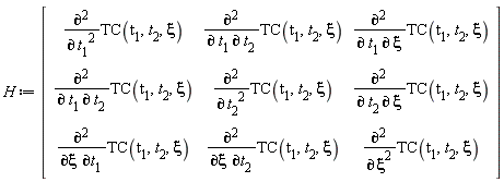

H := Matrix(3, 3, {(1, 1) = diff(TC(t[1], t[2], xi), t[1], t[1]), (1, 2) = diff(TC(t[1], t[2], xi), t[1], t[2]), (1, 3) = diff(TC(t[1], t[2], xi), t[1], xi), (2, 1) = diff(TC(t[1], t[2], xi), t[1], t[2]), (2, 2) = diff(TC(t[1], t[2], xi), t[2], t[2]), (2, 3) = diff(TC(t[1], t[2], xi), t[2], xi), (3, 1) = diff(TC(t[1], t[2], xi), xi, t[1]), (3, 2) = diff(TC(t[1], t[2], xi), xi, t[2]), (3, 3) = diff(TC(t[1], t[2], xi), xi, xi)})
Matrix(%id = 18446746207931281886)
