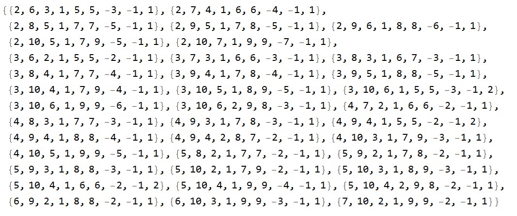

With Mathematica, I got like this picture (a, b, c, d, e, f, x1, x2, x3)
How can I get the correct results?
