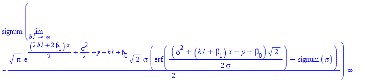

how this integral can be calculated in the simplest form ? the second question is what exactly is done when using assuming? for example when using assuming real, all the functions or parameteres are affected? thanks in advanced
restart:with(IntegrationTools):
(int(int(exp(-(y-beta[0]-beta[1]*x-b0-b1*x)^2/(2*sigma^2))*exp(-b0)*exp(-b1),b0=0..infinity),b1=0..infinity,continuous=true) assuming real)
signum(limit(-(1/2)*Pi^(1/2)*exp((1/2)*(2*b1+2*beta[1])*x+(1/2)*sigma^2-y-b1+beta[0])*2^(1/2)*sigma*(erf((1/2)*(sigma^2+(b1+beta[1])*x-y+beta[0])*2^(1/2)/sigma)-signum(sigma)), b1 = infinity))*infinity
