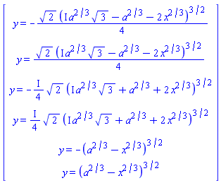

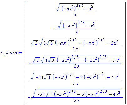

Notice: The reason I am asking the above, is becuase I was doing it this way: I first solve for c from one equation, then use this result in the second equation (this is what one would do normally by hand). but this could result in many solutions and hard to know which to pick to match the book result. That is why I am thinking of using Elminate instead:

#brute force method
c_found:=Vector([solve(eq1,c)])
Vector(6, {(1) = sqrt((-a*x^2)^(2/3)-x^2)/x, (2) = -sqrt((-a*x^2)^(2/3)-x^2)/x, (3) = (1/2)*sqrt(2)*sqrt(I*sqrt(3)*(-a*x^2)^(2/3)-(-a*x^2)^(2/3)-2*x^2)/x, (4) = -(1/2)*sqrt(2)*sqrt(I*sqrt(3)*(-a*x^2)^(2/3)-(-a*x^2)^(2/3)-2*x^2)/x, (5) = (1/2)*sqrt(-(2*I)*sqrt(3)*(-a*x^2)^(2/3)-2*(-a*x^2)^(2/3)-4*x^2)/x, (6) = -(1/2)*sqrt(-(2*I)*sqrt(3)*(-a*x^2)^(2/3)-2*(-a*x^2)^(2/3)-4*x^2)/x})
map(x->simplify(subs(c=x,eq2),symbolic),c_found)
Vector(6, {(1) = y = -(1/4)*sqrt(2)*(I*a^(2/3)*sqrt(3)-a^(2/3)-2*x^(2/3))^(3/2), (2) = y = (1/4)*sqrt(2)*(I*a^(2/3)*sqrt(3)-a^(2/3)-2*x^(2/3))^(3/2), (3) = y = -((1/4)*I)*sqrt(2)*(I*a^(2/3)*sqrt(3)+a^(2/3)+2*x^(2/3))^(3/2), (4) = y = ((1/4)*I)*sqrt(2)*(I*a^(2/3)*sqrt(3)+a^(2/3)+2*x^(2/3))^(3/2), (5) = y = -(a^(2/3)-x^(2/3))^(3/2), (6) = y = (a^(2/3)-x^(2/3))^(3/2)})
Looking at result above, I think I can safely eliminate all y solutions with complex number I in them. This leaves the last two listed above (real y). Which is a little better than before.
